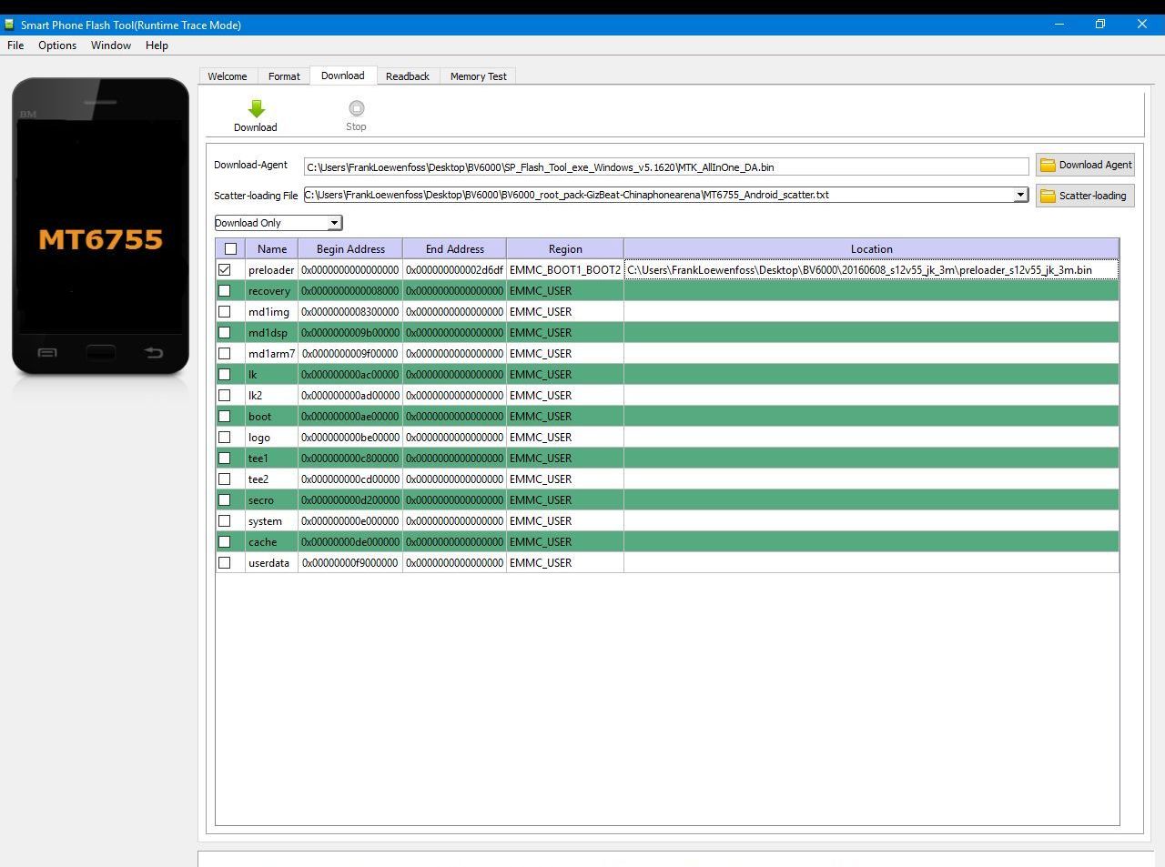

Hey , got the exact same problem.... OTA update to 7.0 failed and ended in a boot loop, tried to flash the official firmware version via sp flash tool on linux, tool finished successfully..... bv6000 wont boot anymore, no factory / recovery mode possible...no reaction from the phone at all....
found a workaround for me.... maybe it works for you as well......
so i used sp flash tool v.5.1644 (linux) and the offical Blackview firmware 20160822-s12v55_jk_3m
removed battery once....
open flashtool and go to the FORMAT area
select Auto Format Flash.... EXEPT bootloader and press play
plugin your phone holding the Volume Up button
if successfull, plug off your phone
go to the flash tool DOWNLOAD area
load the scatter.txt from the original firmware i mentioned above
select only the PRELOADER.bin
select the DOWNLOAD ONLY option, press DOWNLOAD and plug in your phone holding the Volume up button
if finished plug off your phone
Select all files for download, download only, press download and plug in your phone holding the Volume up button again
wait till finished, plug off your phone and restart it......
hope it works for you as well !!!!

I hab the same problem after flashing the original Android 6 Version.
Thats the way I solved it:
1. Starting SP-Flash Tool again and use the same scatter file as before but uncheck everything.
2. Load a OTA flash file from this board and unzip it.
3. Check preloader and in the right box of it click right and select the preloader file from the OTA flash file.
4. Hold Power and Vol up button and connect cable it should now load the preloader
5. Disconnect the phone and power up.
