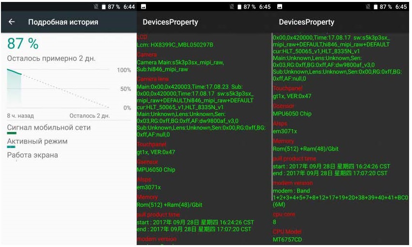

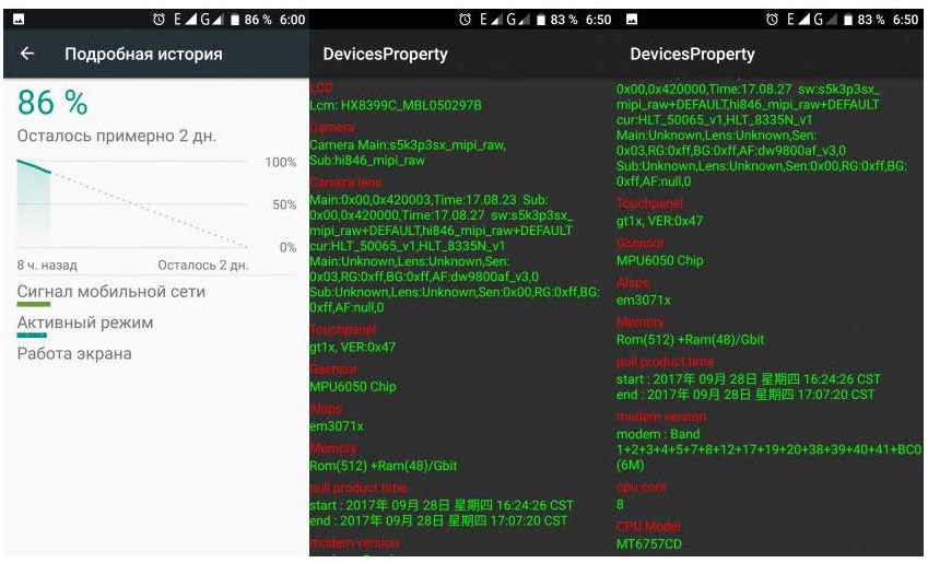

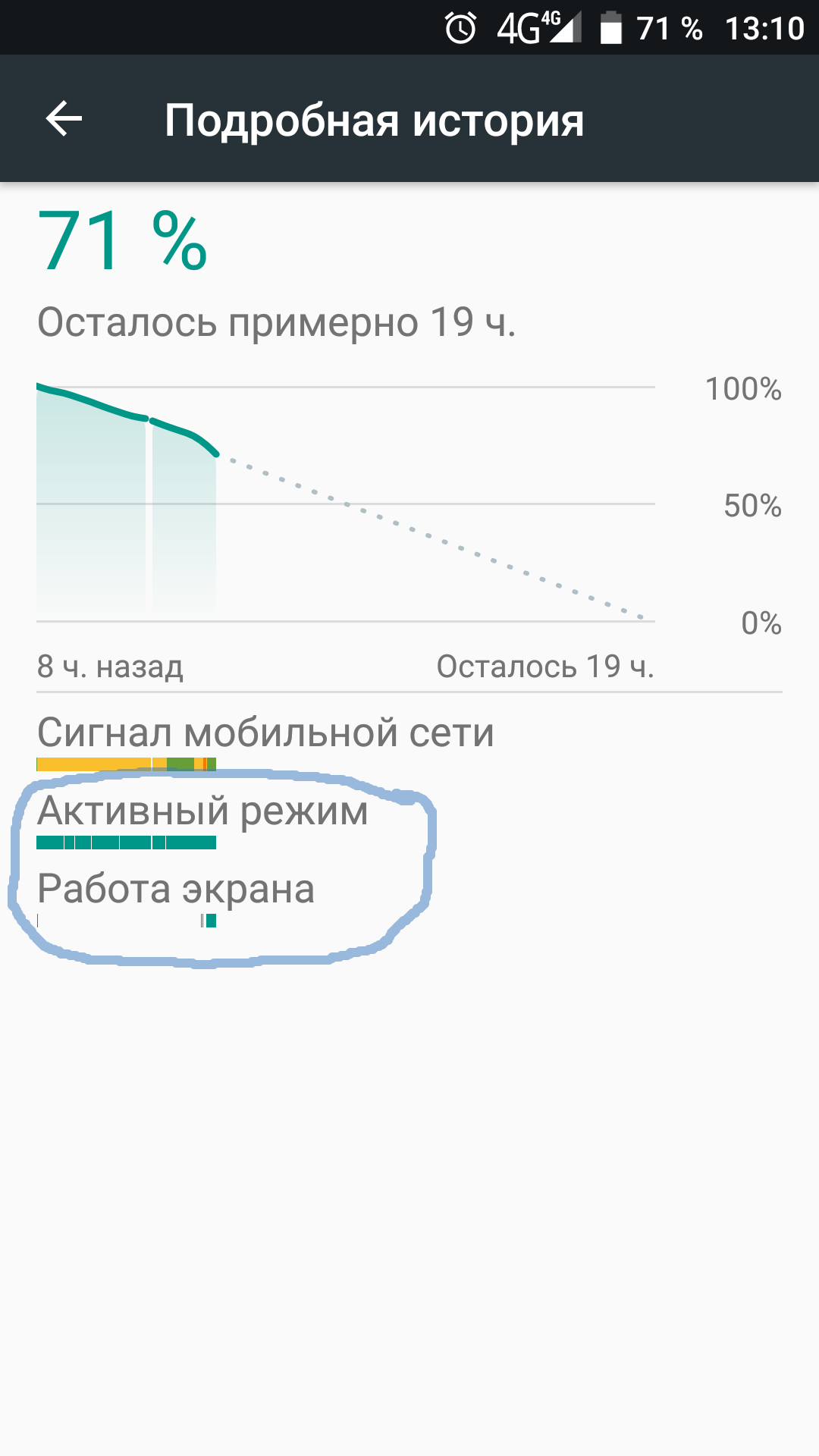

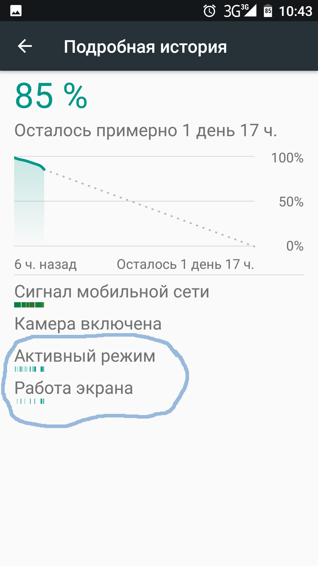

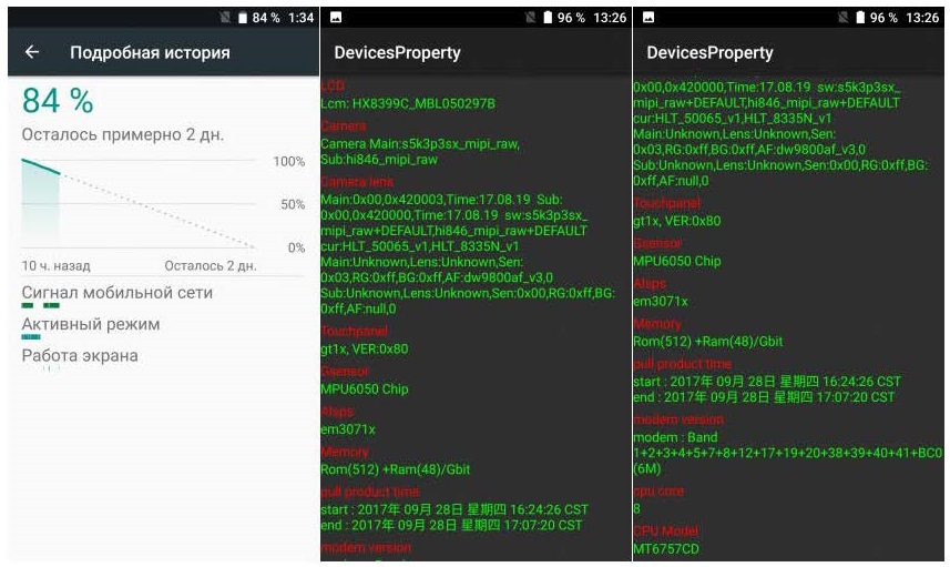

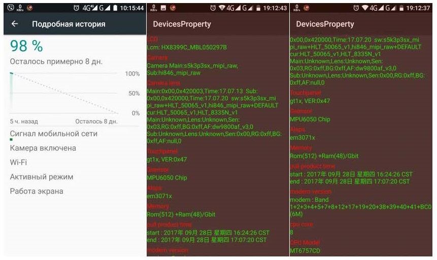

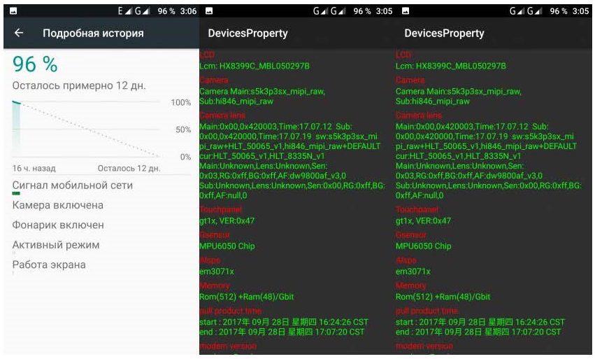

Fri Nov 17, 2017 3:27 am
I present you statistics on several smartphones. Perhaps this will help in resolving the issue with abnormal energy consumption and constant activity, lack of deep sleep. By the way, I also think that spontaneous reboots and the problem of the absence of deep sleep can be related, since most of those who complain of a reboot experience problems with a fast discharge at rest.
