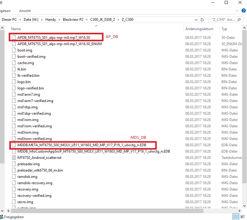

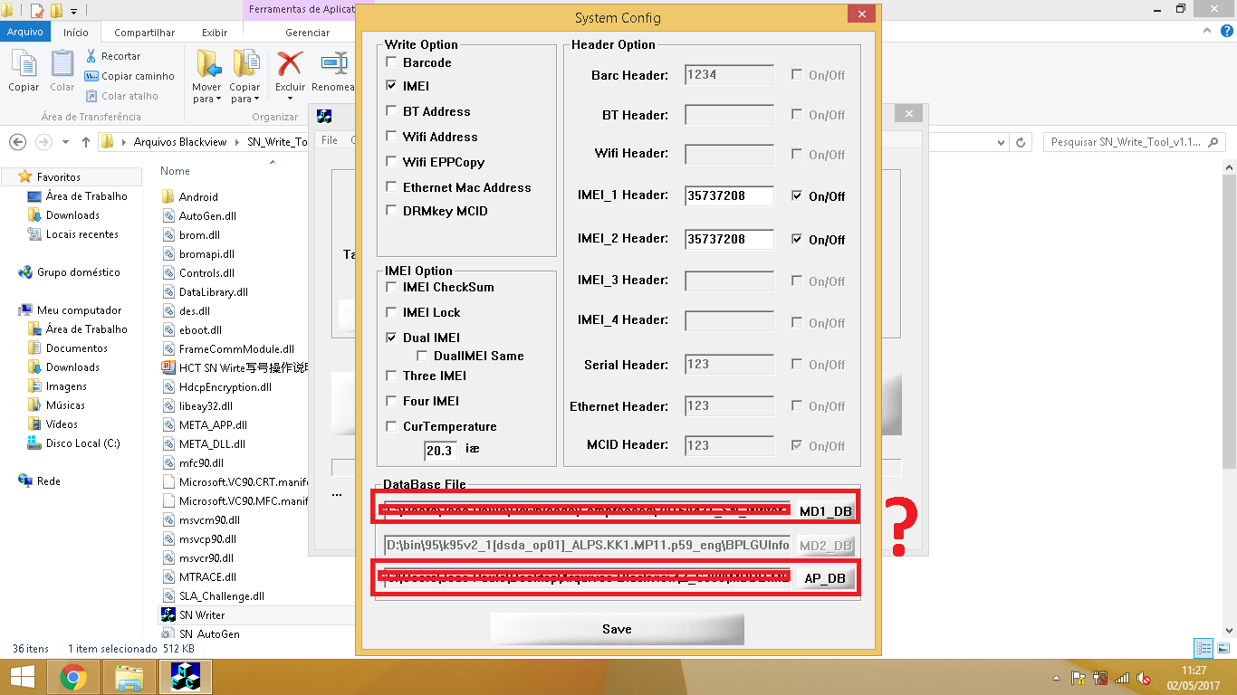

Where can I get these files? MD1_DB; AP_DB? I can not run until the end always crashes.

Did you download the ROM from the forum? If yes, unpack the zip and search for the files.

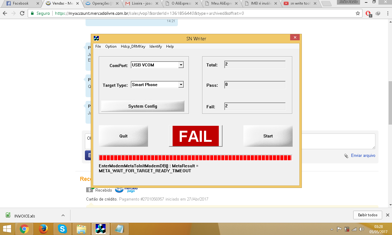

There's always this same mistake ... can you tell me what to do?

I didn't turn on the IMEI Header and it worked for me. Did you follow the installtion instructions of the device on the website of the snwriting tool? Seems like the program can't find your phone.

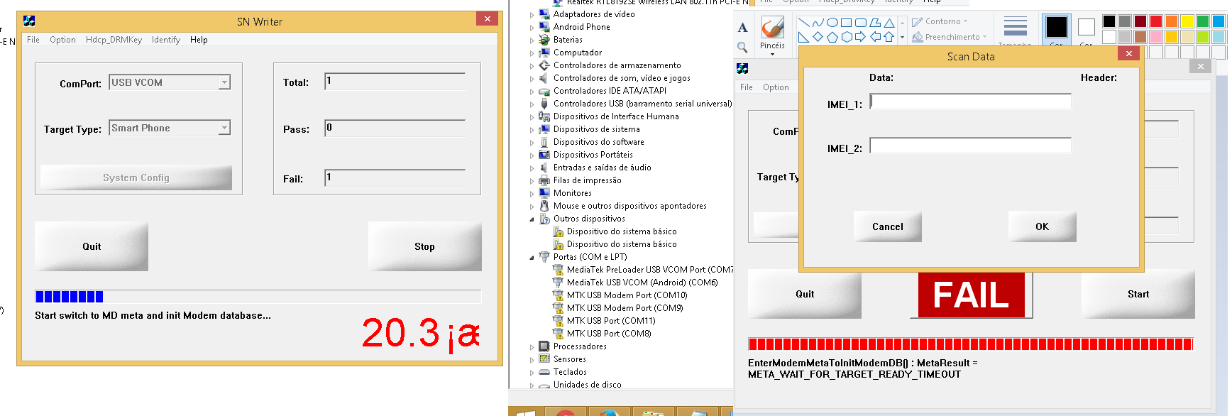

Yes the computer recognizes the device, but when it arrives at that stage it stops ... I do not know what else to do, I already thought about getting rid of the device.

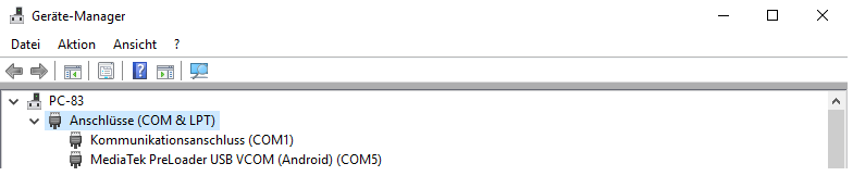

You need the VCOM Drivers. You can get them here: http://www.mediafire.com/file/6n78jodk7ld3aef/MT65xx+USB+VCOM+DRIVERS.zip
Your Device should get recognized as MediaThek Preloader. It doesn't work if it's not.
device manager.png (9.11 KiB) Viewed 9576 times
When you extracted the zip install the drivers via the exe file. After you did this you have to go to the device manager and add a new legacy hardware. Then you choose "install hardware manually from list" --> "show all devices" --> have disk. Now you choose the right folder for your system, that you extracted from the zip file, should be win7 I guess (for win7,8 and 10). I chose the MDMCPQ.inf. Now you should get a selection of drivers. You choose the PreLoader USB VCOM Port driver. After you installed it try again and tell me if this worked or if you even did this before.

Maybe you should try to deinstall all the COM devices you have right now and then install a fresh preloader. Maybe thats the problem. Second thing I recognized is, that it seems like you're using an older version of sn writer than I did. The newest doesn't include only "SmartPhone" under target type. Maybe you try out the new version, there you have to pick "Smartphone no C2k"
Other Question: How do you do it. Do you start the writing process and then plug in the phone? If not, that's the correct way.

Friend I want to thank you immensely, the problem was really the old program, I used the new version and it worked perfectly, my device makes connections and everything else .... I do not know what would happen to me without your help, thank you very much ...
