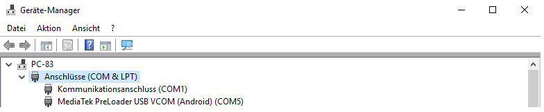

You need the VCOM Drivers. You can get them here: http://www.mediafire.com/file/6n78jodk7ld3aef/MT65xx+USB+VCOM+DRIVERS.zip
Your Device should get recognized as MediaThek Preloader. It doesn't work if it's not.
device manager.png (9.11 KiB) Viewed 9411 times
When you extracted the zip install the drivers via the exe file. After you did this you have to go to the device manager and add a new legacy hardware. Then you choose "install hardware manually from list" --> "show all devices" --> have disk. Now you choose the right folder for your system, that you extracted from the zip file, should be win7 I guess (for win7,8 and 10). I chose the MDMCPQ.inf. Now you should get a selection of drivers. You choose the PreLoader USB VCOM Port driver. After you installed it try again and tell me if this worked or if you even did this before.

Maybe you should try to deinstall all the COM devices you have right now and then install a fresh preloader. Maybe thats the problem. Second thing I recognized is, that it seems like you're using an older version of sn writer than I did. The newest doesn't include only "SmartPhone" under target type. Maybe you try out the new version, there you have to pick "Smartphone no C2k"
Other Question: How do you do it. Do you start the writing process and then plug in the phone? If not, that's the correct way.
