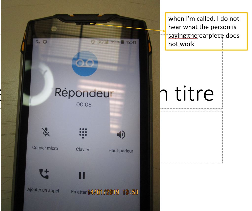

inside ear piece no sound
Wed Jan 16, 2019 9:05 am
dear Blackview,
after 2 month , there is no sound from the ear piece when i  call or recieve a call, the ear piece doesn't work, please find enclosed my picture with the encircle earpiece problem,
Re: inside ear piece no sound
Thu Jan 17, 2019 7:23 pm
Hi dear! Unfortunately it looks like an hardware fault. You'll have to contact your seller to have your phone replaced/repaired under warranty.

Try to put under water.  :)  There can be some dirt.

We have 2 devices showing this defect.
Factory reset seems to temporarily solve the problem - so I guess this is a software issue.
Any thoughts on that ?

During hardware testing, all is good.
This happens only during calls. (Scrambled or no sound at all)

Confirmed as software issue from my end.
Got a 6800Pro for the kid. Straight out of the box, earpiece wasn't working
Did an OTA update, and now it works.
Will monitor to see if problem persists or reappears
