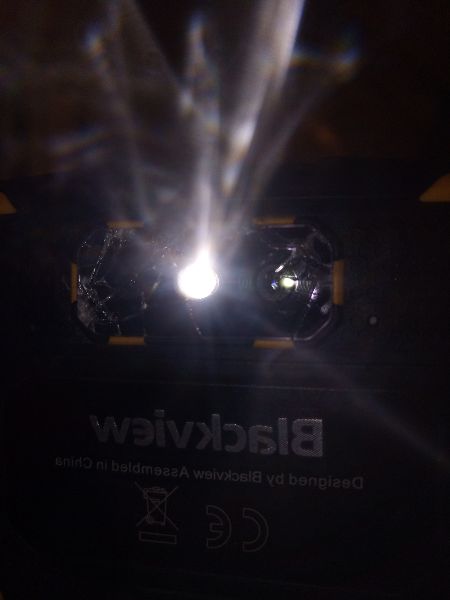

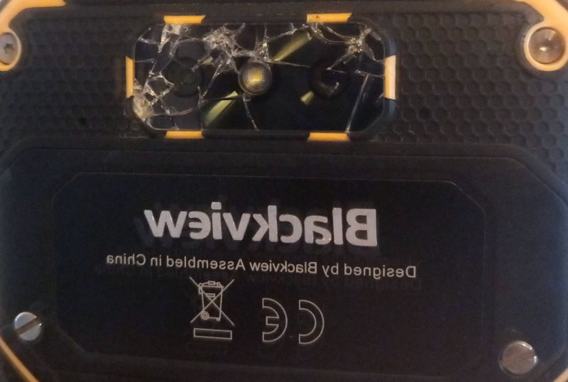

Hi,
I was afraid of this since I got the phone. Protruded camera port is an obvious weak point and - if we are talking about a rugged phone - a design flaw. Yesterday my BV9600Pro had splipped off my hand and fell on an asphalt surface on its back from no more than 40cm. Dent in plastic close to the bottom screw suggest the corner was the first point of contact with the ground but finally the glass camera shield was hit too and didn't withstand. Despite everything is still working I'm afraid the phone is no longer IP-68. Unless there is no light source in front of the camera, it's able to make fine shots. I had to remove a glass shard from my finger after examinig the damage...
Here how it looks like
Phone's selfie in the mirror
Phone's selfie with flash
Can this glass be replaced alone or entire back panel must be replaced?
In either case please tell the engineers they should never again make protruded camera ports in rugged phones. Thin rubber frame does not protect it at all :(
