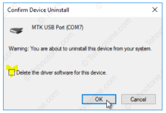

UNINSTALL ANY OTHER DRIVER RELATIVE TO MTK, AND DON'T REMOVE ONLY THE DEVICE, BUT THE DRIVER, SO WHEN YOU UNINSTALL ANY DEVICE MAKE SURE TAHT THE BOX SHOWN IN THE PICTURE IS FILL, SO DELETE THE DRIVER SOFTWARE FOR THIS DEVICE.
Drivers Delete Image.PNG (97.06 KiB) Viewed 66715 times
