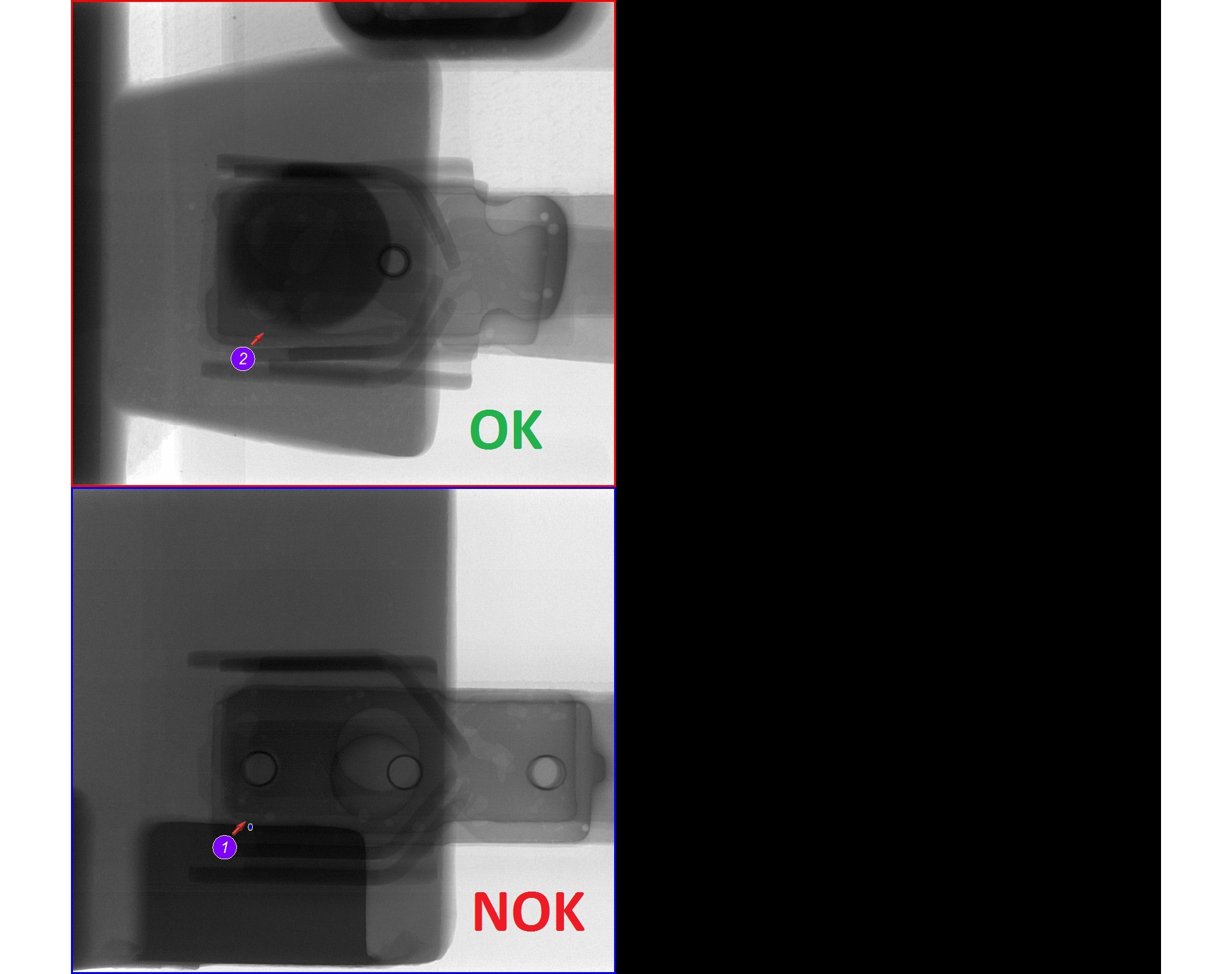

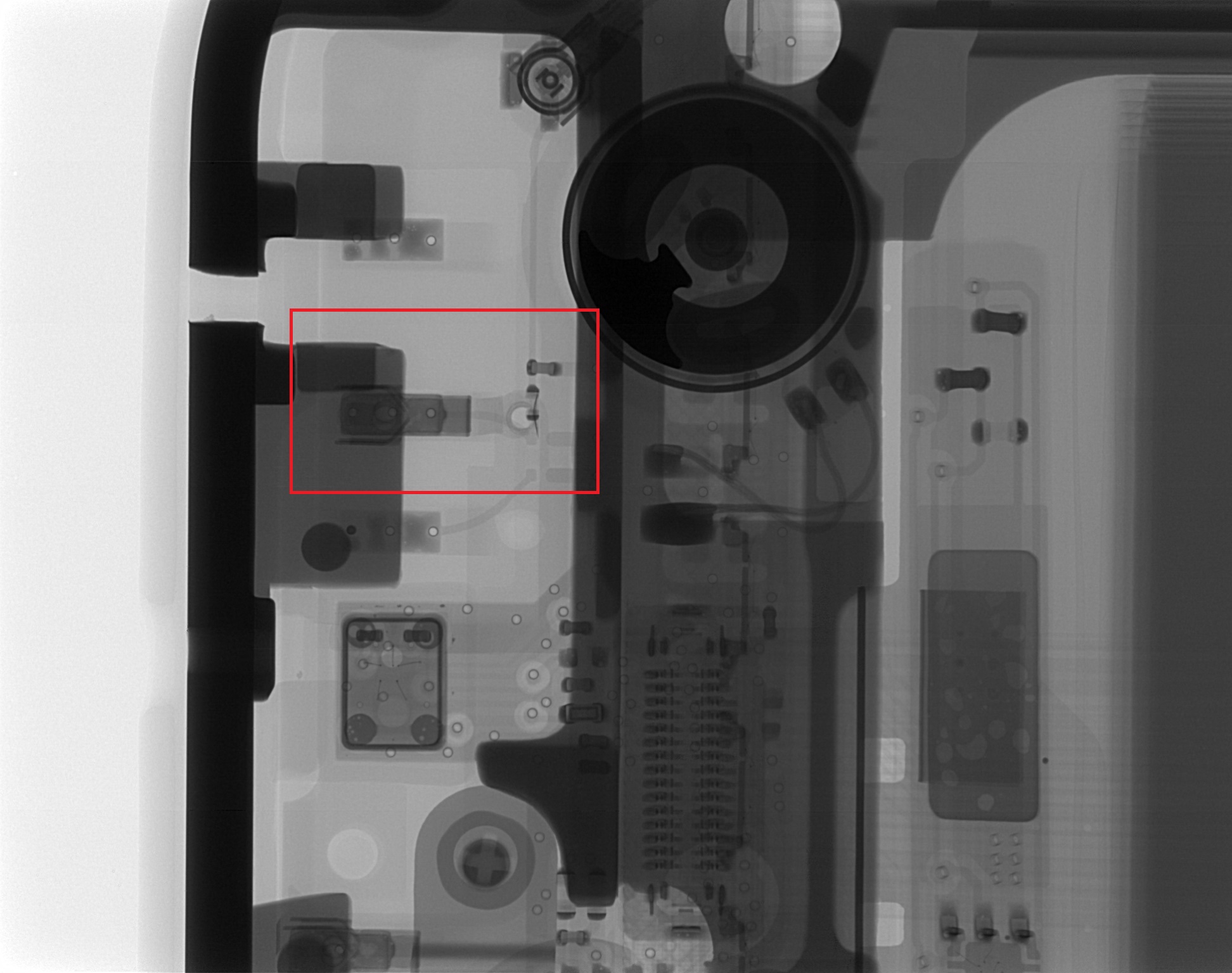

My friend is working at rentgen at his job and he testes both my phones, both are Blackview P6000. He discovered that there are missing parts in phone, which is not working while talking. I marked on photos where are good parts and where are missing parts. I recommend that I order new PCB from you so I can try to replace with failure one and try if it works or just send this phone to repair service if they can do something. In this case, send me closest possible service for Slovenia customers! Greetings!

To have your device replaced under warranty, you'll have to contact your seller. He will honor warranty terms.
Here you can find official repair services near your country:
http://blackview.hk/global-agents/
