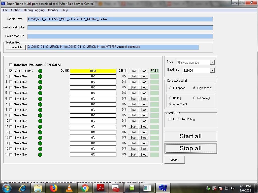

Everything done/completed successfully as per the tutorial. Attached screenshot of "DL OK" & also "PASS" but,still only Red LED is blinking. Not booting. Stuck at Blackview & powered by android logo.
DL OK_BV8000 Pro.jpg (211.18 KiB) Viewed 8814 times

If flashing can't solve the issue, neither recovery mode is working, unfortunately there's nothing more i can do to help you.
The only solution will be contacting your seller to have your device replaced. :(

You did not followed the tutorial as it was described previously. Its strictly stated that "Never use format+download option you should always use firmware update option. Am afraid you have formated all the partitions thats why phone gets stuck at boot. Try to install some custom rom and check if it works. Custom Rom you can find on 4pda i think.

Actually, I have tried flashing ROM in normal mode as per tutorial but it's not working. That's why I tried flashing in "Format + Download All" mode. I'll try with Custom ROM & shall update you.
Thank you so much for your advice.
