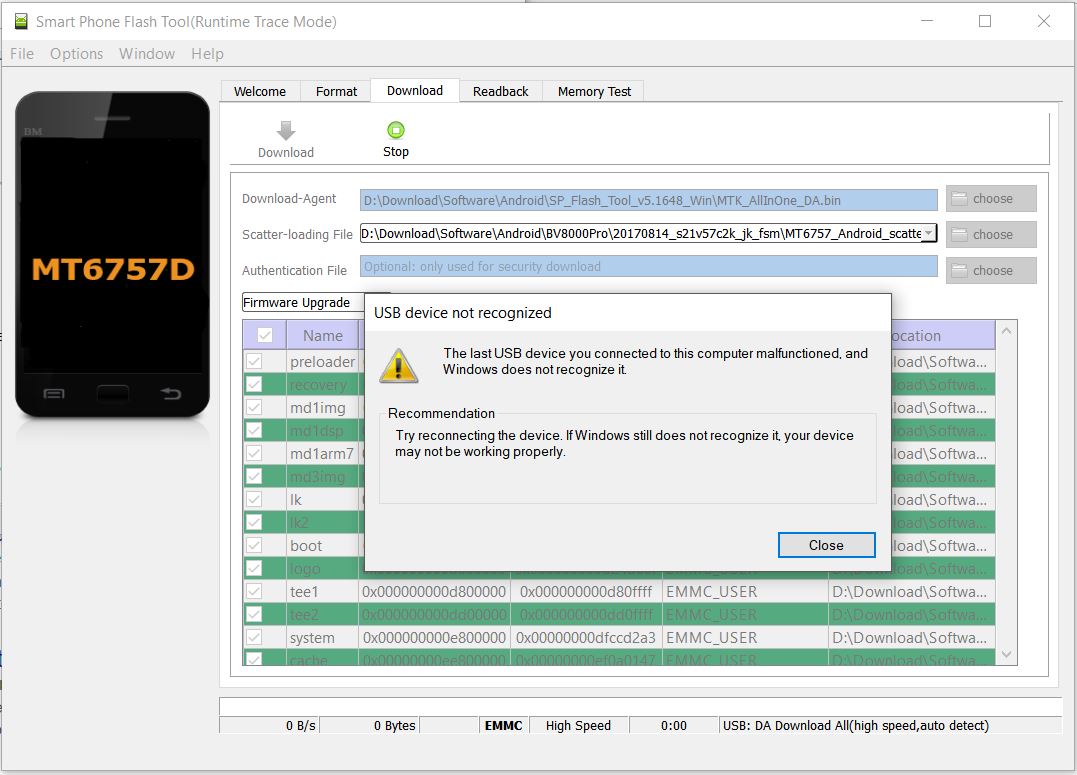

I downloaded the BV8000Pro_blackview_20170804 ROM from the link posted here and flashed it using SP Flash Tool. The phone started normally, but the original problems stayed.
After that I am unable to flash another ROM. The PC will not recognise it when it when it is turned off - I tried with several different computers, OS and drivers. I read that I need to enable USB Debugging before switching off - that's why I ask.

Here is the error I see when I try to flash the phone:
This is after I flashed the BV8000Pro_blackview_20170804 ROM. Before that it was ok - I flashed two ROMS succesfully:

I managed to flash the latest firmware. I used a very old Laptop with Windows 7 x32 and the latest MT65xx USB VCOM DRIVERS. Testing now.
