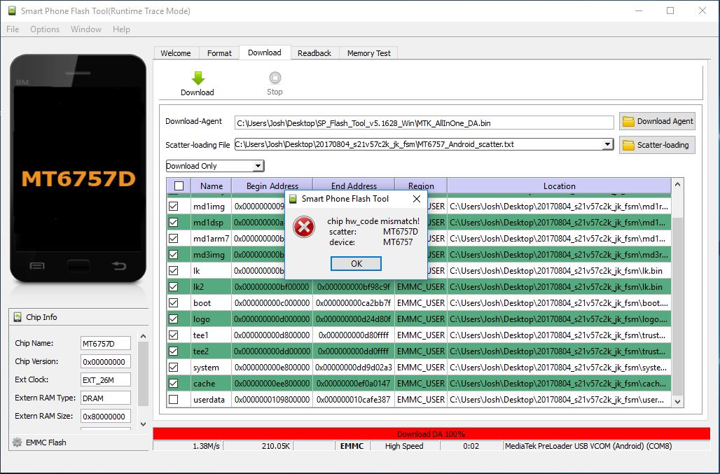

Get the following error. This latest firmware seems a bit of a flop. I think i'll wait until the OTA update is fixed. Dont want to brick my phone!!

This error message was discused in an other thread and is no bug of the update file. You need to use the right version of flashing software, the correct driver and maybe change the used usb-port to one with more power/unplug other usb-devices that use power. The chipset will be recocnised correct then.
Can I please have a link to this thread as I can't find it. The instructions for updating the bv8000 pro still don't include any instructions for flashing.
Thank you
the instruction on using sp flashing tool is the same as other phones as it recognizes the cpu and then writes according to the scatterfile, has you enabled usb debugging?

yes, usb debugging is enabled. still get same error.
