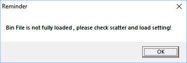

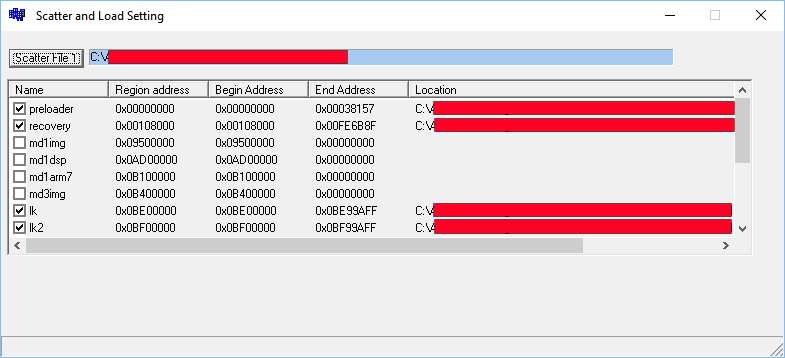

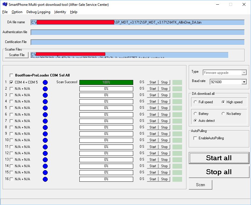

Followed these great, detailed instructions, but ran into a problem at the end. Using the SP Multi Port D/L Tool, the scan was "successful (100%)," but, when I clicked "Start All," I received the error "Reminder Bin File is not fully loaded , please check scatter and load setting," and the software would not proceed any further. I looked at the "scatter and load" settings within the software, but there wasn't anything that could be changed. I'm too much of a noob to try to make changes within the actual scatter file (or anywhere else, for that matter) without guidance. Suggestions? Thanks.
(*The red lines in the photos are my doing - blocking personal identifiers.)
SP Multi Port Software UI
SP Multi Port UI.jpg (130.51 KiB) Viewed 11797 times
"Bin File" error
Scatter and Load Setting
Scatter and Load Setting.jpg (44.97 KiB) Viewed 11797 times

Re: Simple Flashing Tutorial
Wed Jan 03, 2018 9:37 am
Popcorn
Try to download the ROM again, and also download the checksum generator (maybe the file is corrupted) .... unpack ROM folder and then copy all files from the Checksum generator folder to the ROM folder.
Run checksum.exe and wait for the process to end. then try step 4 again.
That's what it should look like:
https://drive.google.com/file/d/1_ajJC7UeE-M3Z_RqKDcJp2Mmomj6ZXR1/view?usp=sharing
all files have Location...
I hope it will help
