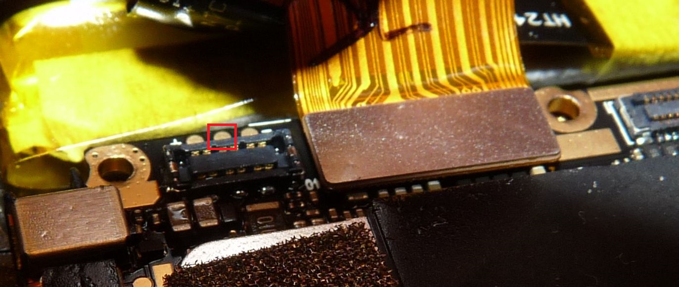

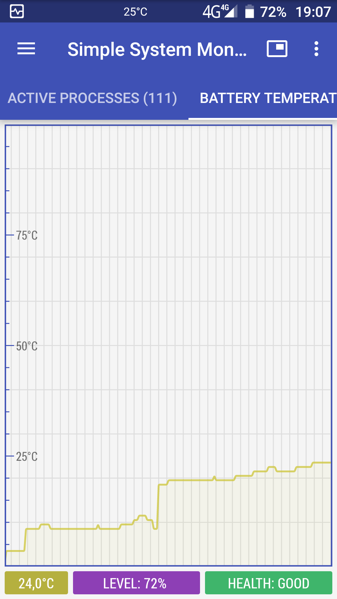

I've got a problem with battery temperature and many times my phone isn't charging (temperature below 5 Celsius degrees). Temperature is jumping randomly from -20 to +7 degree, most often not charging range. Then I dissmantle the phone unhook the battery and give some touch to the battery connector and temperature returns to correct value. The battery connector has 6 solder points connected in pairs (I measured resistance between them at is around 1 Ohm), so two for power plus, two for power minus and two in center for temperature I think. The device behave like have a "cold solder" in temperature joints only because it doesn't restart. So last time I dissasembly the phone I took a soldering iron and resolder one of center joints (to second center joint I have too big tip in soldering iron)
and for two days the temperature was ideal, but today morning it drops down to 2 Celsius and a moment later rise to 7-10 degrees. After few hours it recovers to normal temperature again (this jump was for no reason, I'm not using phone at this time)
Of course if it is wrong today it can broke every moment, so I want to repair it to end. Is my idea that it is a cold solder is correct? What else I can do to repair the battery temperature, maybe I should resolder other joints?

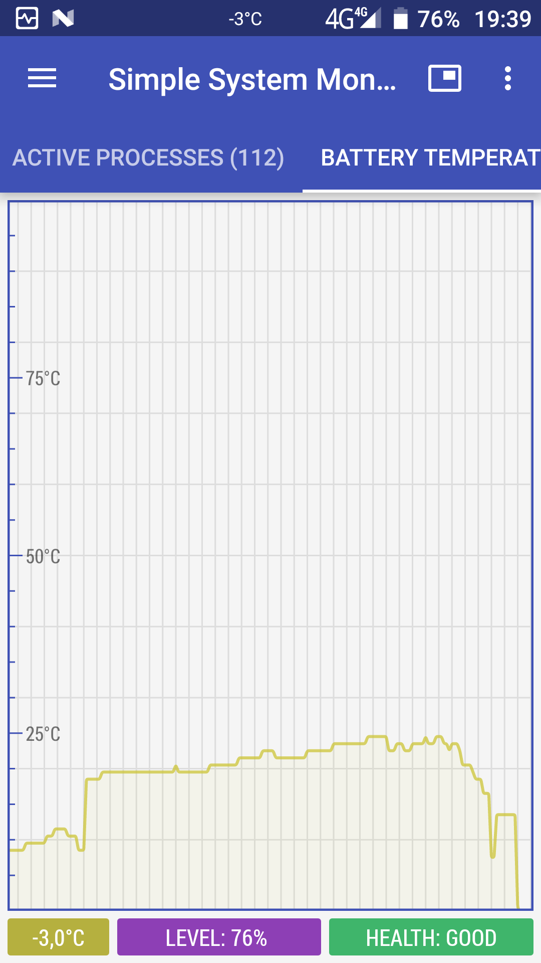

mac3000
Posts: 17
Joined: Thu Jun 08, 2017 7:37 am
Re: Battery temperature problem
Thu Feb 28, 2019 6:41 pm
And now another drop to -3 degree, phone was laying attached to computer.

mac3000
Posts: 17
Thu Feb 28, 2019 8:38 pm
If the problem is in battery or charging board why touching battery connector on motherboard helps for some time?

mac3000
Posts: 17
Sun Mar 03, 2019 9:09 am
How do you know that these elements are faulty? I say it once more time if battery temperaure is so bad that phone doesn't charge even 1 percent through 10 hours I can do everything put it in cold, in hot, shake the phone, disassemble, touch everything inside on motherboard or charging board and nothing helps, but if I dsconnect the battery, take the needle or something similar and touch the battery connectors temperature returns to normal and phone charges.
