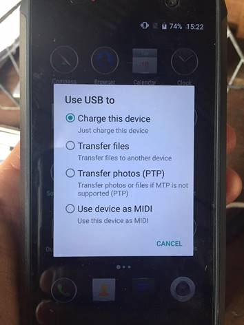

Hi everyone - could use some help here.  I manage a large team collecting data in the field on BV8000Pros (running Android version 7.0).  When they bring devices to the office, I must connect them to a PC and download their collected data - I do this up to 30 times in a day!  Every time I connect the device, the USB connection defaults to "charge this device" and I have to do a few extra steps to get it to the "transfer files" connection type.  I am wanting to set the default USB connection to "transfer files" to save me some steps and have tried the suggestions here using Developer Mode (https://www.addictivetips.com/android/how-to-set-the-default-usb-connection-type-in-android-6-0/) but they don't seem to work on my BV8000Pros.  Even with Developer Mode on and following instructions on that link, it still defaults to "charge the device."
Can anyone provide some assistance?  Many thanks in advance....

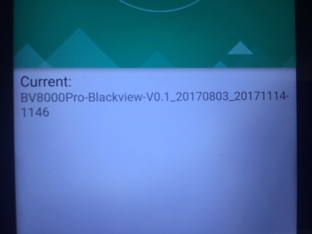

Hi Admin, it took me a while but I think that I successfully flashed to the 20171114 firmware version as you suggested but I am still having the same result.  See screenshot below to see if I did it correctly?  I set the USB connection to "file transfer" mode, unplug it, but when I plug back in it goes back to "charging only" mode every time.  I tried the developer mode trick again but it is still not working.  Can you provide any other suggestions?  I am still looking for a solution to make the default USB connection to "file transfer."  Thanks in advance...
