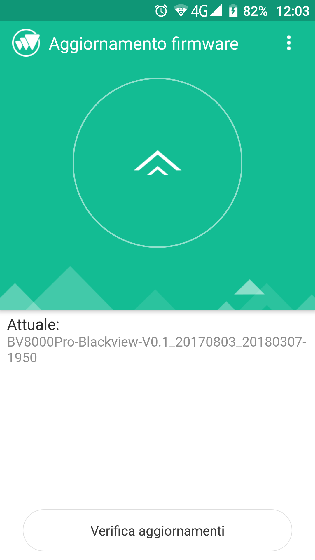

mmmmmmm this means that the BV8000Pro adapter is working with another phone but not with the BV8000pro... so the adapter isn't faulty.
What's your firmware version? did you upgrade it recently? do you have problems also with other cables/chargers?

Ok, i will try and my firmware version is in the screenshot
This
