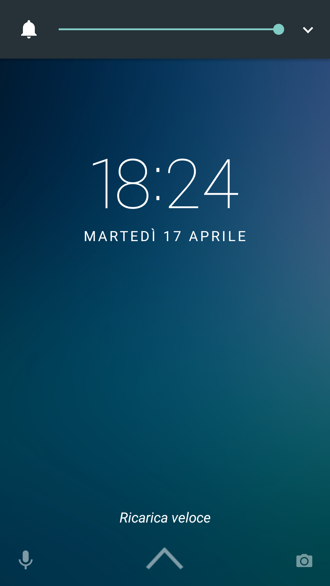

Well, I am using the original charger and cable that came with the phone and I never got the "Fast charging" message on the lock screen (only "charging"). Can anybody confirm a "fast charging" message on the lock screen ?
Re: [SOLVED] How do I know if it is charging at 9v?
Tue Apr 17, 2018 4:29 pm
Here is a screenshot from my BV8000 Pro under charging.
"Ricarica veloce" = Fast charge in Italian language.
