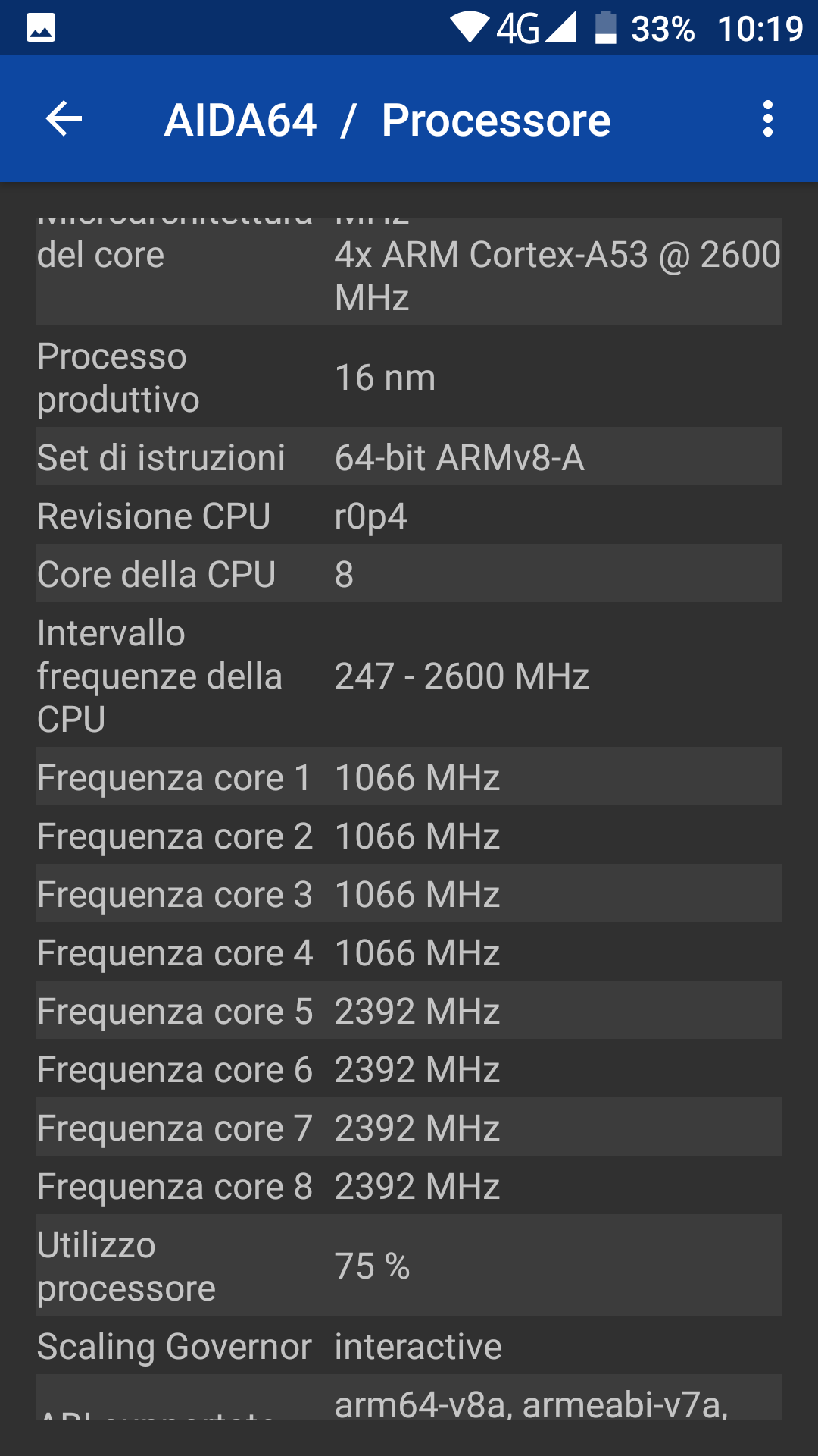

I think the issue may be the CPU governor. I tested with several apps and they all show that after waking up the phone the CPU works like this:
- cores 1,2,3,4 are working at around 1.7 GHz
- cores 5,6,7,8 are working at around 2.4 GHz
This is happening all the time, no matter what the CPU load is (it is visible on the screenshots).
At 18% cpu load and on 90-100% cpu load it is the same.
Can someone with BV8000Pro please install a CPU monitoring app and report if the behavior of CPU Governor is the same?
Thanks in advance for that.
I am using the AIDA64 app, but many other apps are showing the same results.
Also AIDA64 reports that the CPU Governor type is "interactive", but because my phone is (still) not rooted I cannot see the governor parameters.

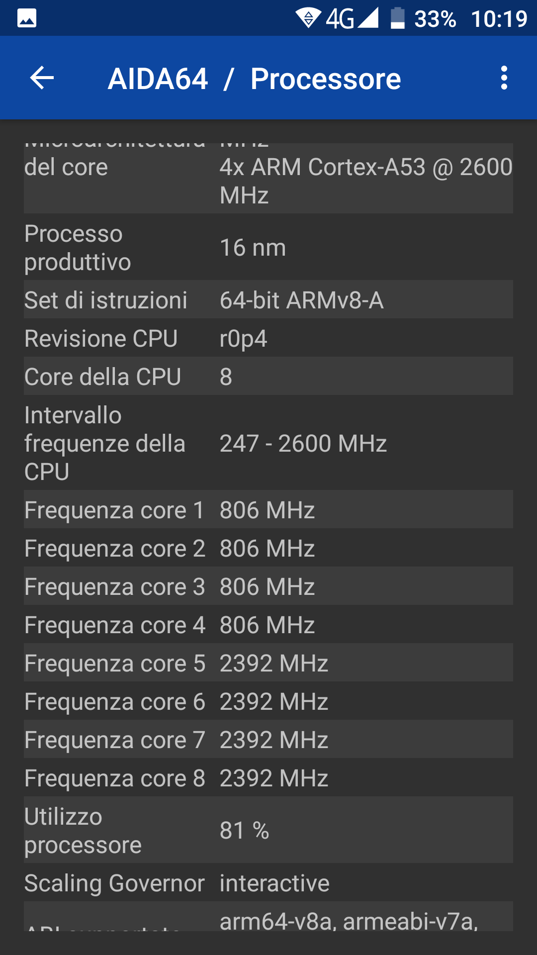

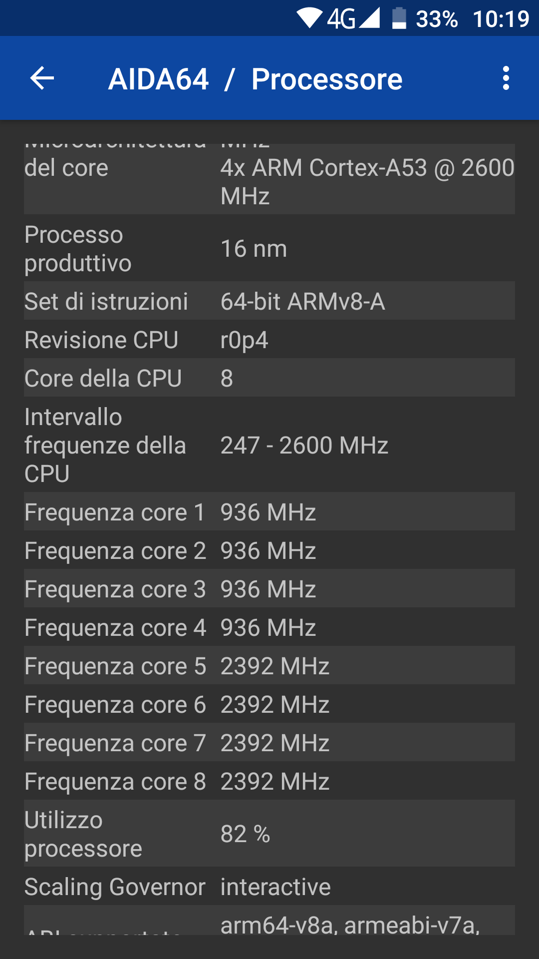

rkolev wrote:
I just wanted one more time to ask if someone can help me by installing a CPU monitoring program on their BV8000Pro and tell me how their CPU is working. I used AIDA64 and several other programs and they all show information similar to the pictures above. Does anyone have the same problem or is just me ?
That's my device.
Re: [SOLVED] BV8000Pro is overheating - CPU is at almost full speed most of the time
Posted: Wed Mar 21, 2018 11:06 am
by rkolev
Hmm, it looks like your cores 5,6,7 and 8 are at 2393 MHz (full speed) all the time (when woke up). Just like mine. Why is that? I have other phones (with mediatek chipsets) which are even disabling most of their cores when running light-weight applications like AIDA64. Just BV8000 Pro is having all its cores running all the time and half of them at full speed. So strange...
AIDA64 is flawed.
Check with the CPUSpy app and you'll see the real behaviour ;)
