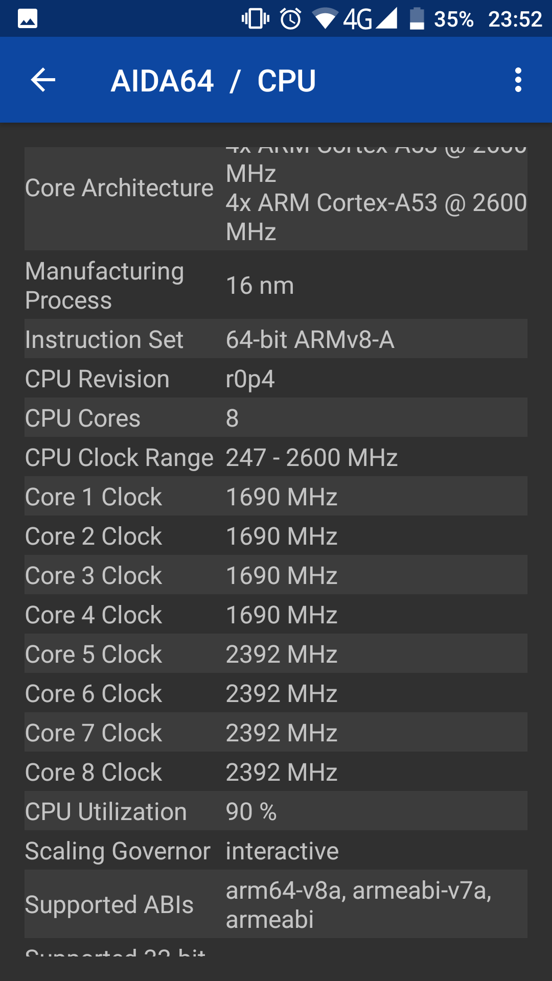

I think the issue may be the CPU governor. I tested with several apps and they all show that after waking up the phone the CPU works like this:
- cores 1,2,3,4 are working at around 1.7 GHz
- cores 5,6,7,8 are working at around 2.4 GHz
This is happening all the time, no matter what the CPU load is (it is visible on the screenshots).
At 18% cpu load and on 90-100% cpu load it is the same.

I am using the AIDA64 app, but many other apps are showing the same results.
Also AIDA64 reports that the CPU Governor type is "interactive", but because my phone is (still) not rooted I cannot see the governor parameters.

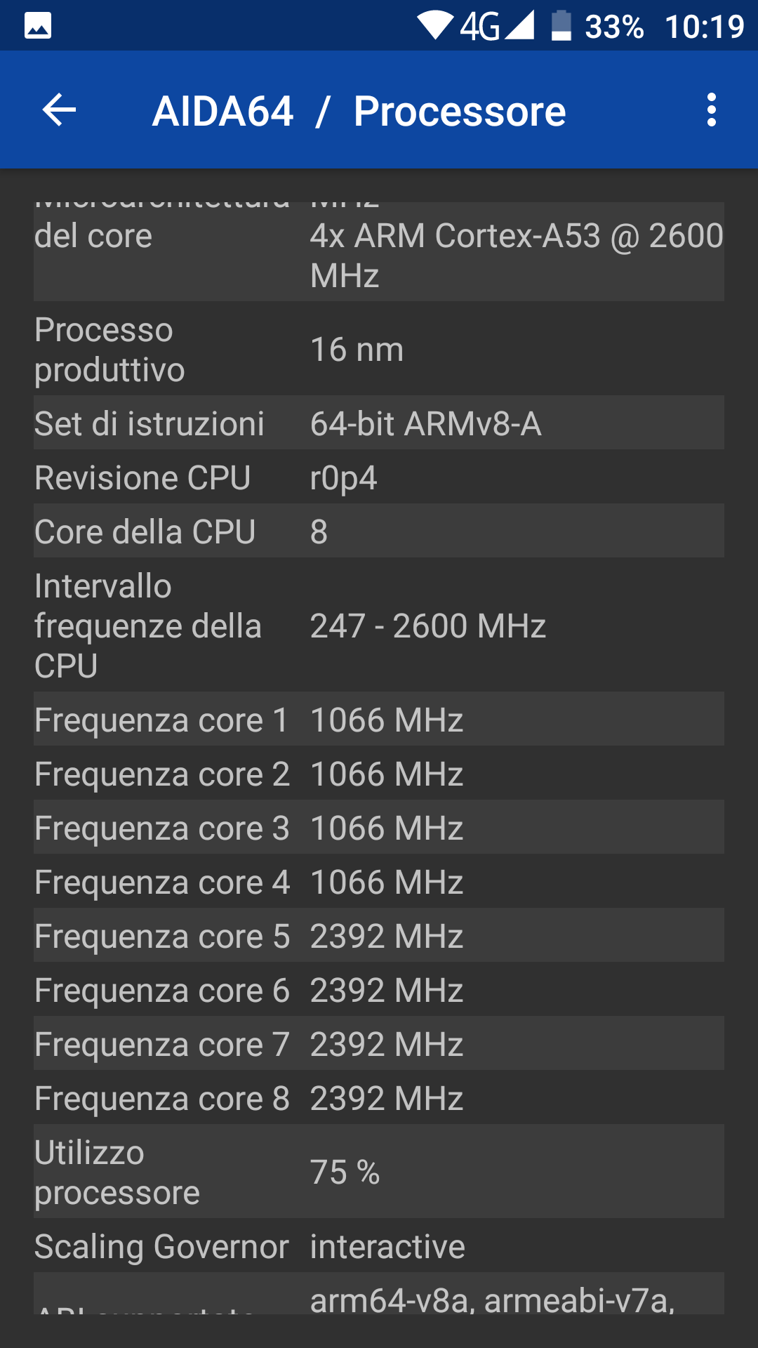

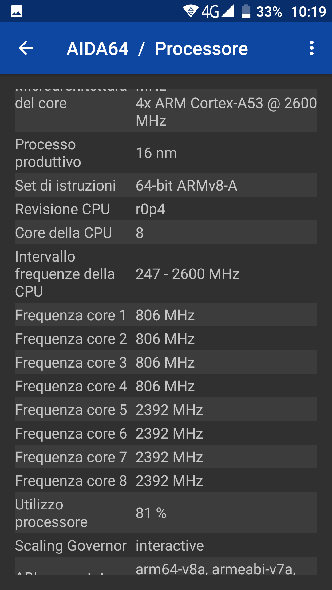

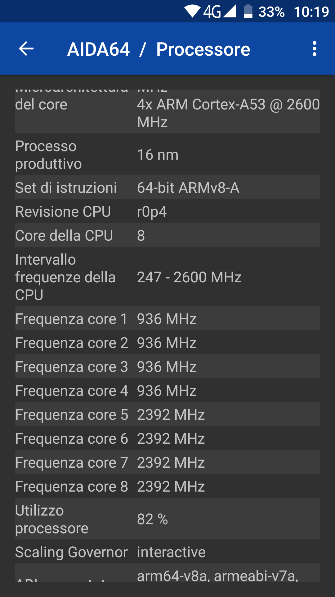

I just wanted one more time to ask if someone can help me by installing a CPU monitoring program on their BV8000Pro and tell me how their CPU is working. I used AIDA64 and several other programs and they all show information similar to the pictures above. Does anyone have the same problem or is just me ?
Re: [SOLVED] BV8000Pro is overheating - CPU is at almost full speed most of the time
Wed Mar 21, 2018 9:24 am
That's my device.

Wed Mar 21, 2018 11:06 am
Hmm, it looks like your cores 5,6,7 and 8 are at 2393 MHz (full speed) all the time (when woke up). Just like mine. Why is that? I have other phones (with mediatek chipsets) which are even disabling most of their cores when running light-weight applications like AIDA64. Just BV8000 Pro is having all its cores running all the time and half of them at full speed. So strange...

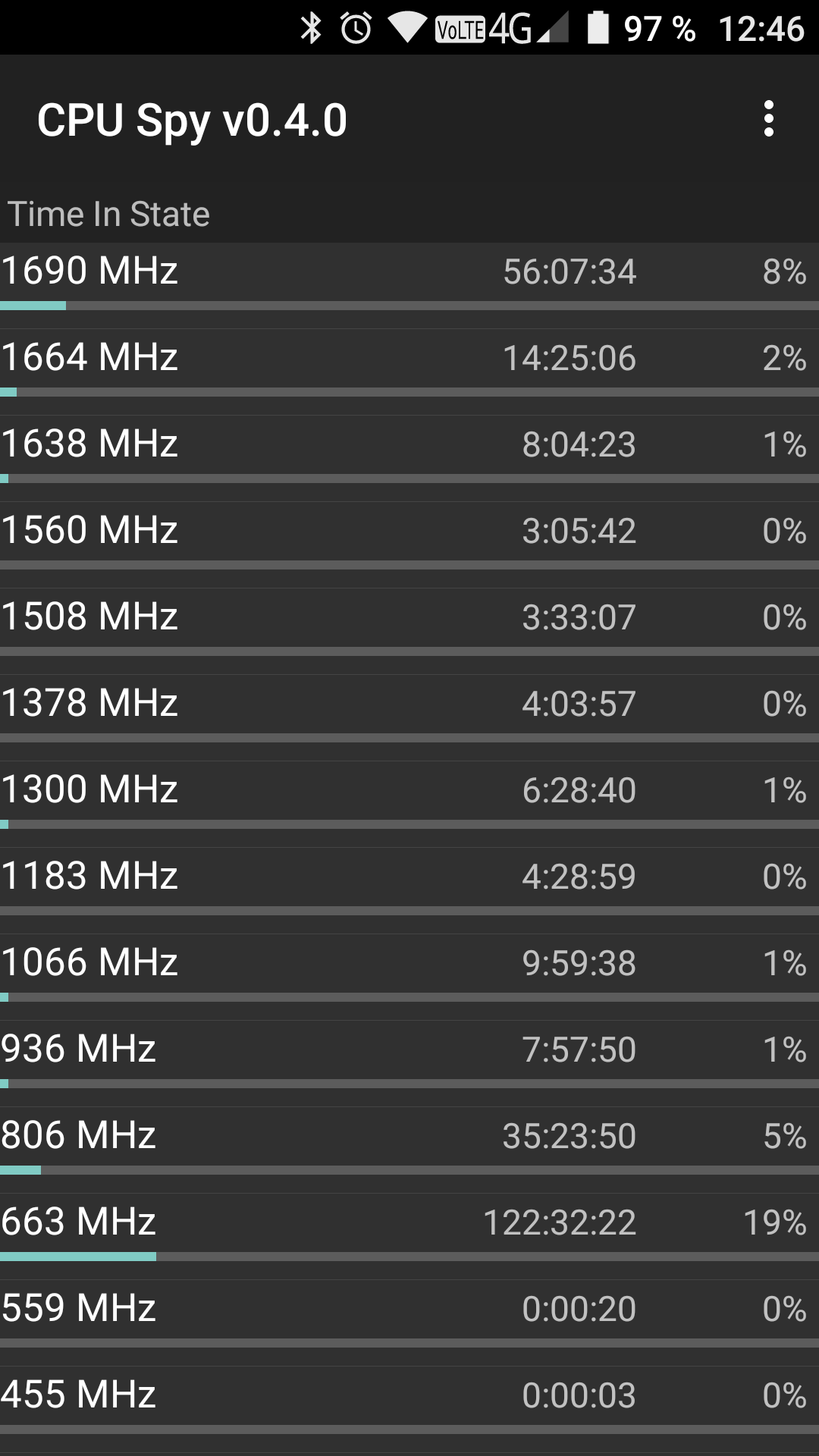

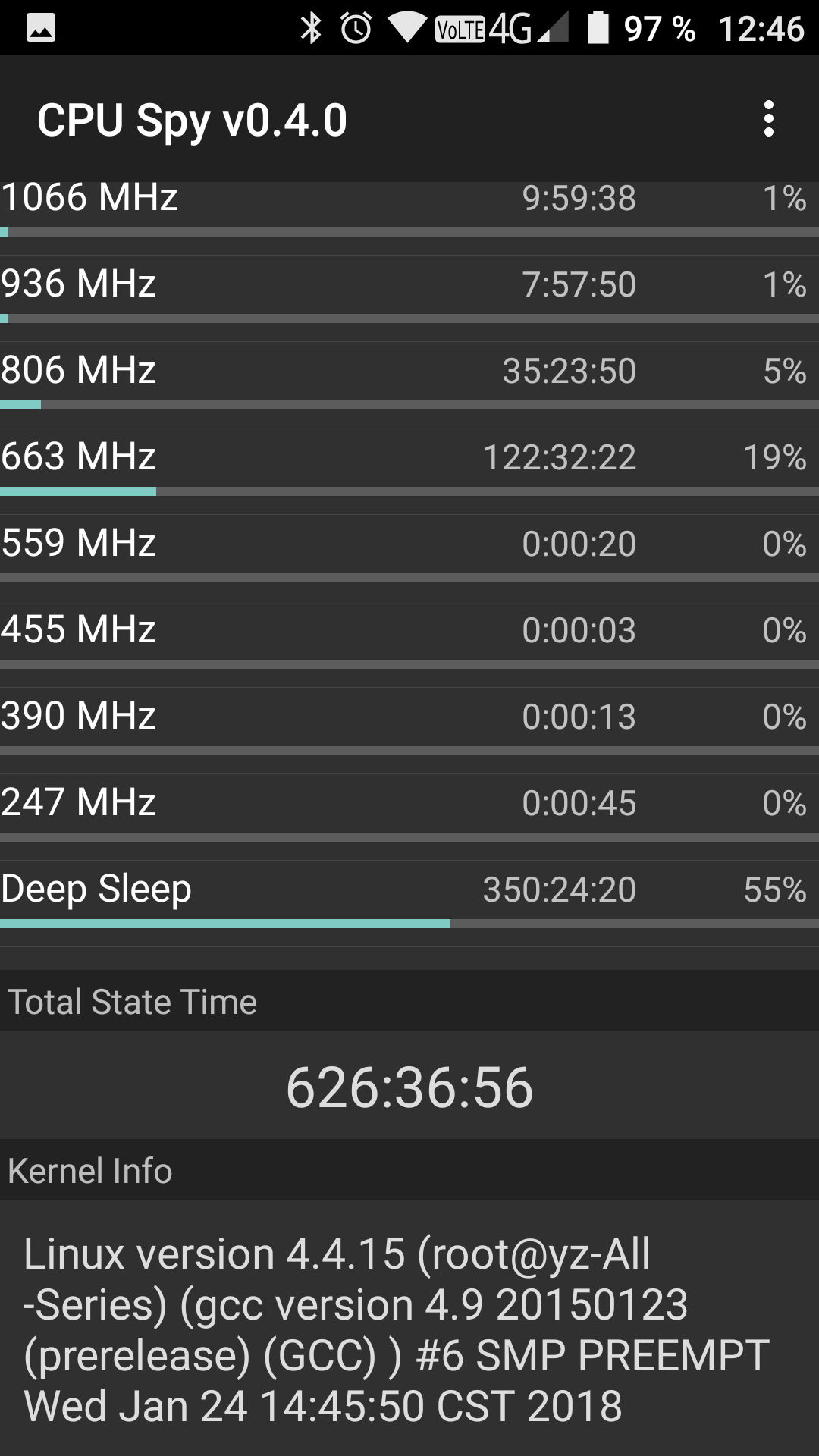

AIDA64 is flawed.
Check with the CPUSpy app and you'll see the real behaviour ;)

Thu Mar 22, 2018 6:53 am
Well I am not sure I use CPU Spy correctly but it shows that the CPU is running at 1690 MHz as max speed which I guess is below the max speed of the MT6757 processor. Maybe it only shows the first cluster (cores 1-4). However I tried with CPU-Z and Kernel Adiutor and they all show information similar to AIDA64.

Thu Mar 22, 2018 12:03 pm
These are the pictures of my CPU SPY
