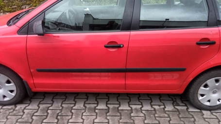

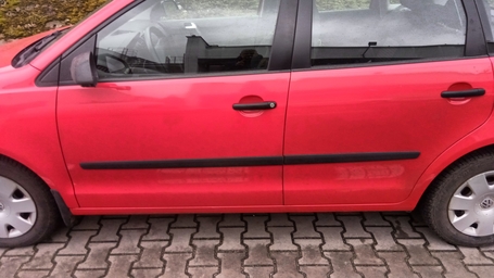

And i have the same problem too. My Rom version: Bv8000Pro-Blackview-V0.1_20170803_20171227-1550
Still red is pink :-((( But not always, it depends on the lighting.
Photo taken outside, natural light:
Standard camera app and Pro Photo, white balance auto, default setting
Standard camera app and Pro Photo, white balance cloudy
As you can see, there is almost no difference, but ... Pictures taken under artificial light:
