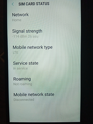

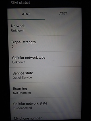

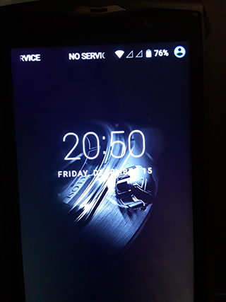

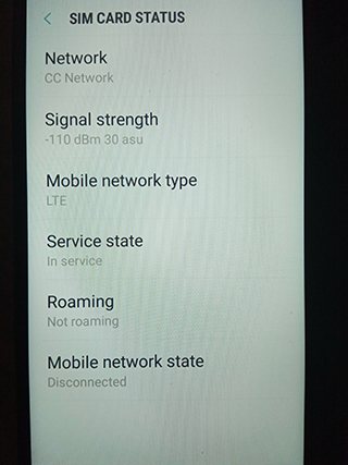

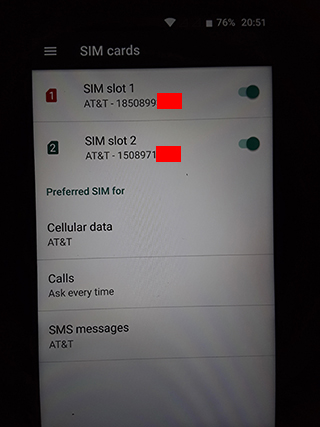

wshtek
Posts: 14
Joined: Thu Dec 14, 2017 5:44 pm
Re: BV8000 Pro - Weak Radio/Signal Strength?
Sat Dec 16, 2017 3:43 am
J7 with each sim
Blackview with both sims installed and 0db.
