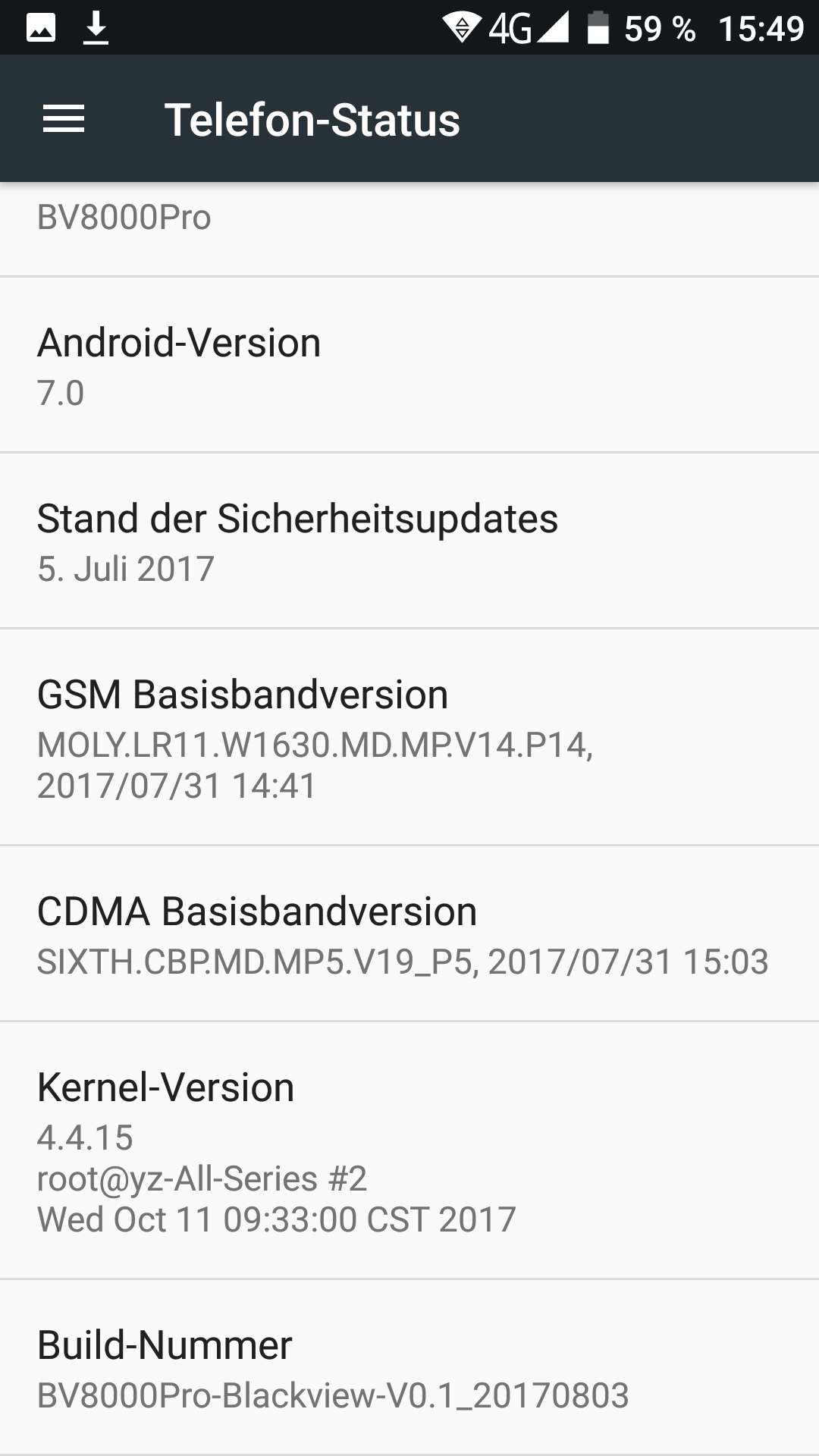

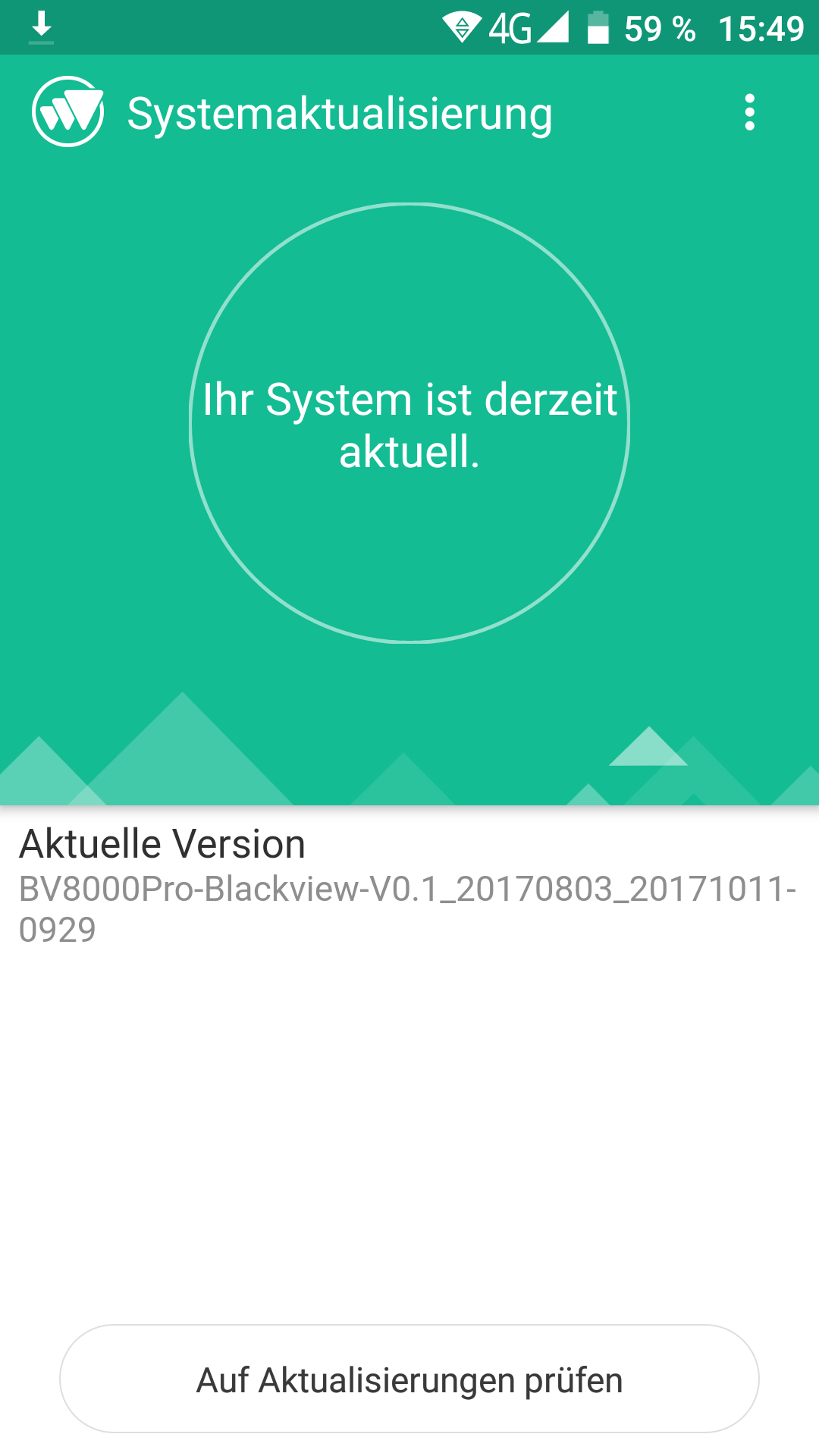

Hello
I installed the new firmware and made a factory reset.
Nothing has changed.
