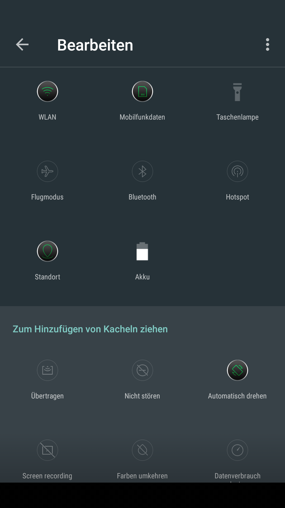

1.) NFC: I can't find a shortcut in the area, where all the other switches for WiFi, Flight Mode, etc. are. (see attached screenshot).

1) Where's the shortcut to enable/disable NFC?
