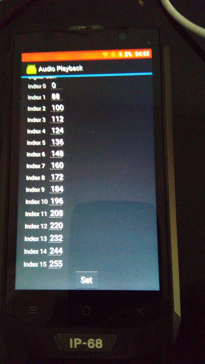

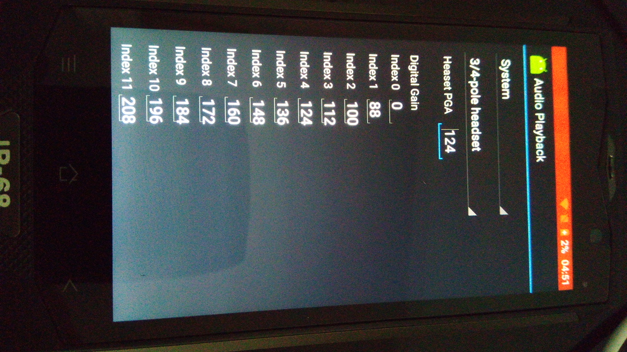

i did it and the index 15 is 255.
I took two pics to show you
What shoud i do ?

when you have the index set so high you should lower it start from the bottom and change it to 240 and work your way to index 14 to 235
etc etc etc.
see if this helps you
