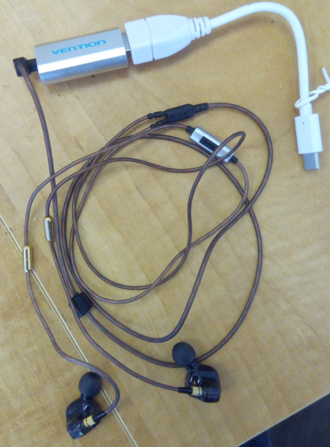

As a workaround (stable and good) I'm using the following adapter:
https://www.aliexpress.com/item/Vention ... 0.0.XjaOYX
In the attached picture I have the setup of KZ ATE headset (including mic) connected to the sound card adapter with 90 degrees connector which in turn is connected to the USB-C to USB mini cable.
Works fine.
[update] Sound quality with the Vention sound card is mainly suited for calls. It lacks Bass so it is not really for music lovers.
