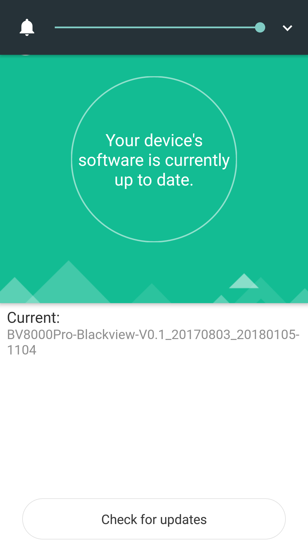

shawn.stockford
Posts: 4
Joined: Wed Nov 01, 2017 6:12 pm
Re: [TRACKED AND ALMOST SOLVED] Bluetooth issues
Thu Mar 08, 2018 8:38 pm
BV8000Pro-Blackview-V0.1_2017083_20180105-1104 is the current firmware I have installed. And I have followed the instructions three separate times with not change in the Bluetooth behavior when connected to my car radio.
Thu Mar 08, 2018 9:34 pm
1) Can you flash your device to the latest firmware version (20180124), perform a factory reset and try the instructions again?
2) Are you using your car's bluetooth to play music, calling or both?
