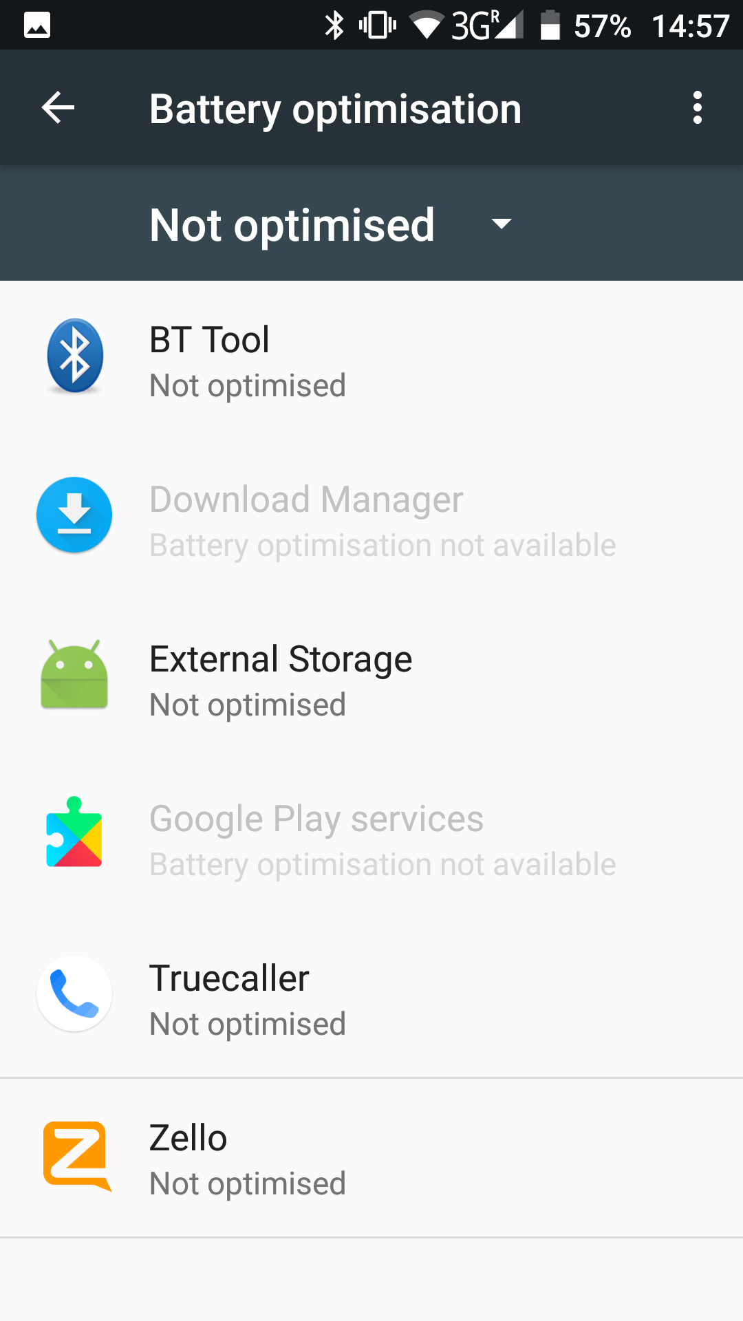

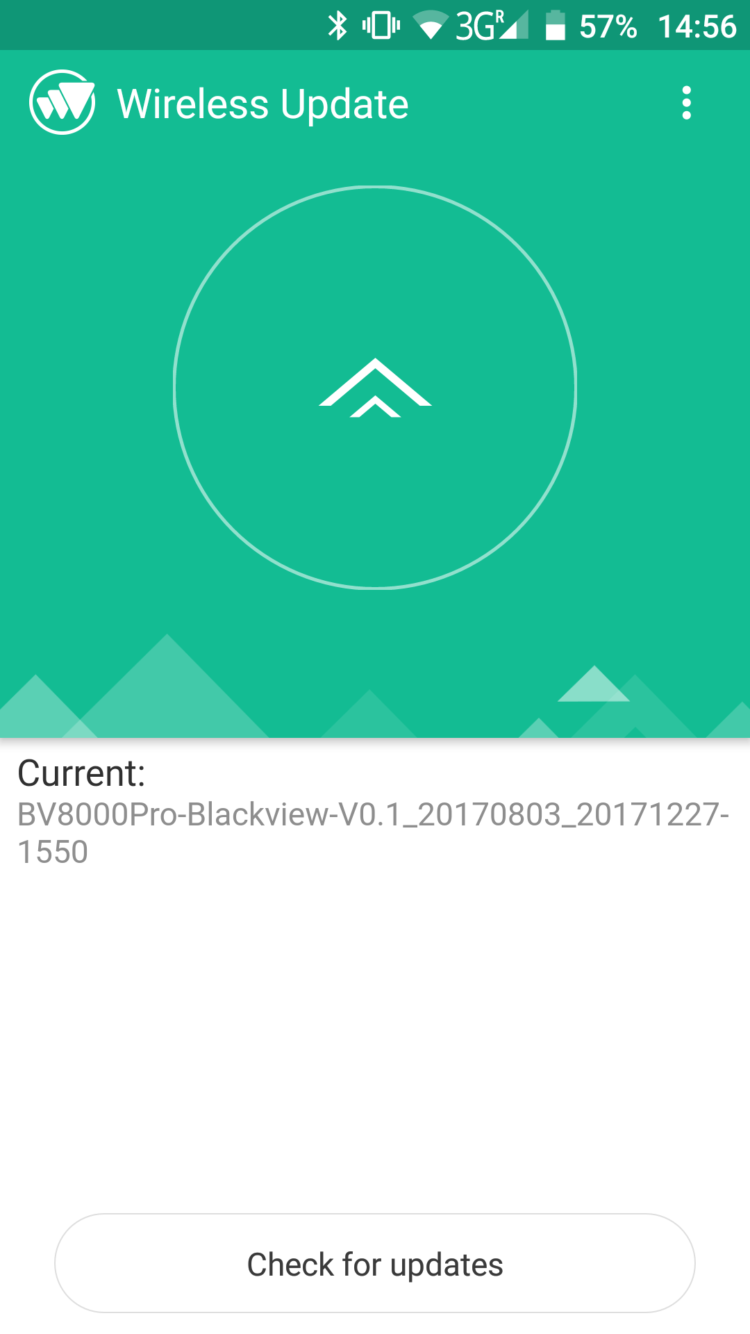

I updated to the latest firmware as per screenshot.
The Bluetooth has become unstable, but only every now and then. I changed it as per screenshot and it is better again.
So far no problems making calls and listening to music.
