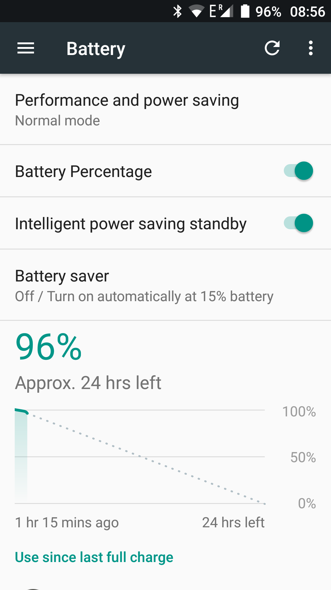

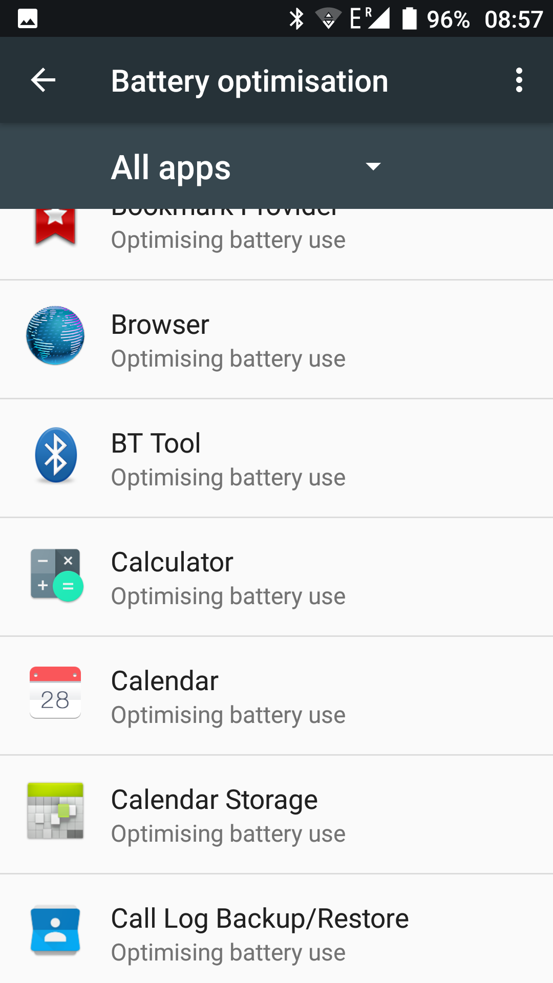

After I did the update to the latest firmware my Bluetooth issues came back. So far using Intelligent battery on and BT Tool not optimised so far I haven't gotten any issues. If I set all my Bluetooth settings to not optimised it does create a bit of battery drain in comparison to having it optimised. Need to test it over a couple of days with different settings.

If I set the Intelligent Battery off and the rest standard it drops my Bluetooth connectivity. The way I have it at the moment is the only way that it works apart from not optimising all the Bluetooth settings. But will test it some more.

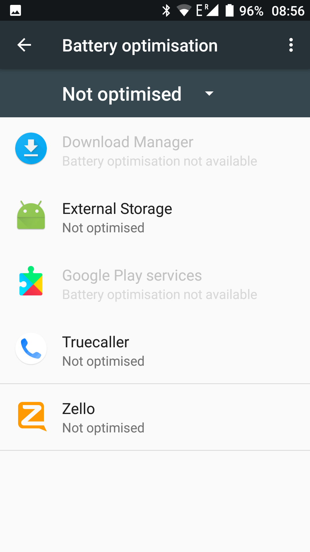

1) Did you perform a factory reset after the update? this is important!
2) Did you try every fix that has been posted in this thread? Fix As:
- Disable battery optimization for every bluetooth service (Bluetooth MIDI service, BT Tool, Bluetooth sharing) and for every app that will use bluetooth to transmit data (your music player, Call manager, telephone dialer app and so on).
and
- Disable the "Standby Intelligent power saving" setting?

Why don't you try to optimise the Bluetooth settings and keep Intelligent Battery On. That seems to have sorted my Bluetooth issues out. Also try Bluetooth Tool not optimised and Intelligent Battery On. Both those settings seemed to have solved it for me.
