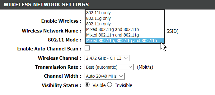

At the moment I have only one router at home. It's an old D-Link DIR-655 (link) with the following setup:
