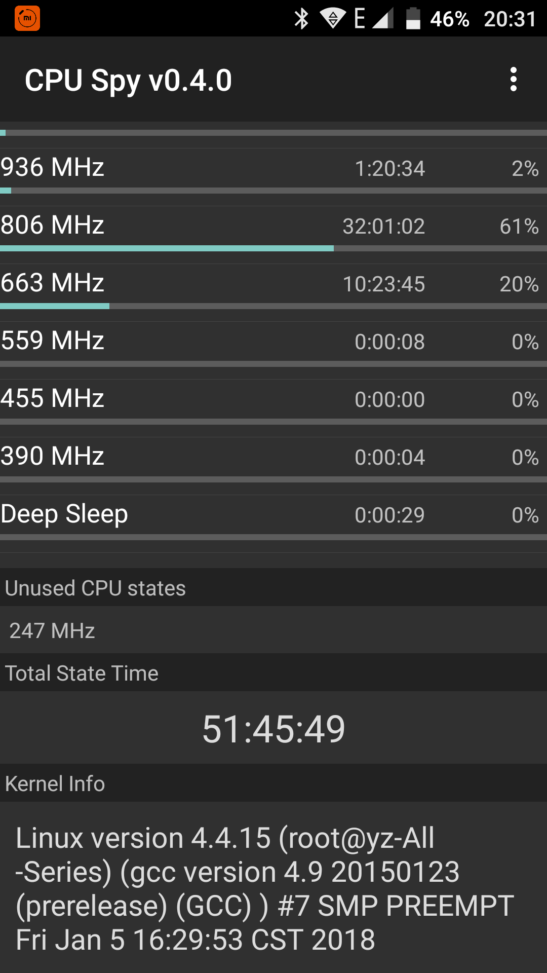

Re: [TRACKED] Update 20171227-1550 - Battery Drain again?
Mon Jan 08, 2018 7:39 pm
29 seconds deep sleep in around 52 hours... wow :shock:
Running on 800 Mhz most of the time... wow 2 :shock:

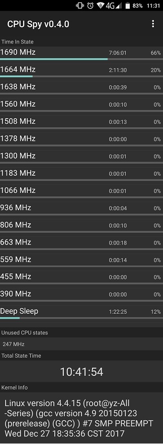

spit_fox
Posts: 9
Joined: Tue Jan 24, 2017 8:03 pm
Tue Jan 09, 2018 1:36 pm
Yes.
Did the factory reset, and here is the CPU.
It does not look good.

Posts: 74
Joined: Sun Sep 24, 2017 5:31 pm
Location: Germany
Wed Jan 10, 2018 5:02 pm
100 hours runtime and still 29 seconds deep sleep.
