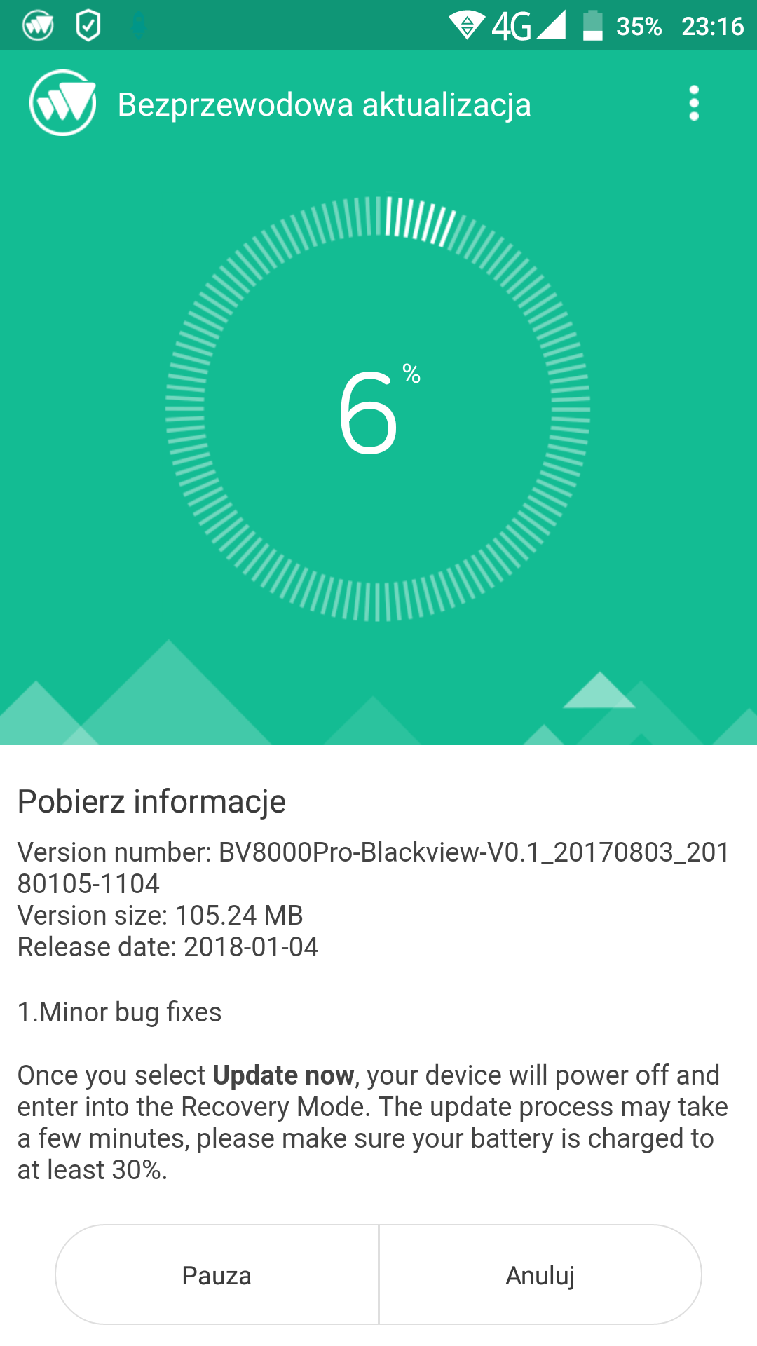

I have the same problem after OTA update 20180105.
