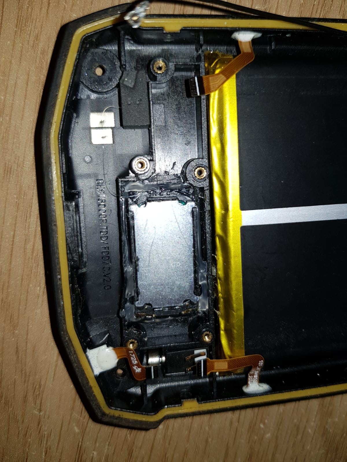

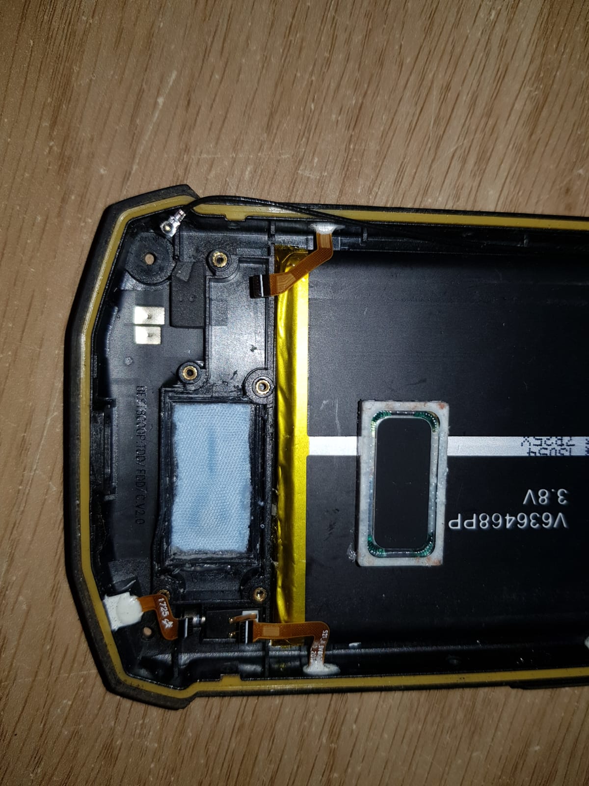

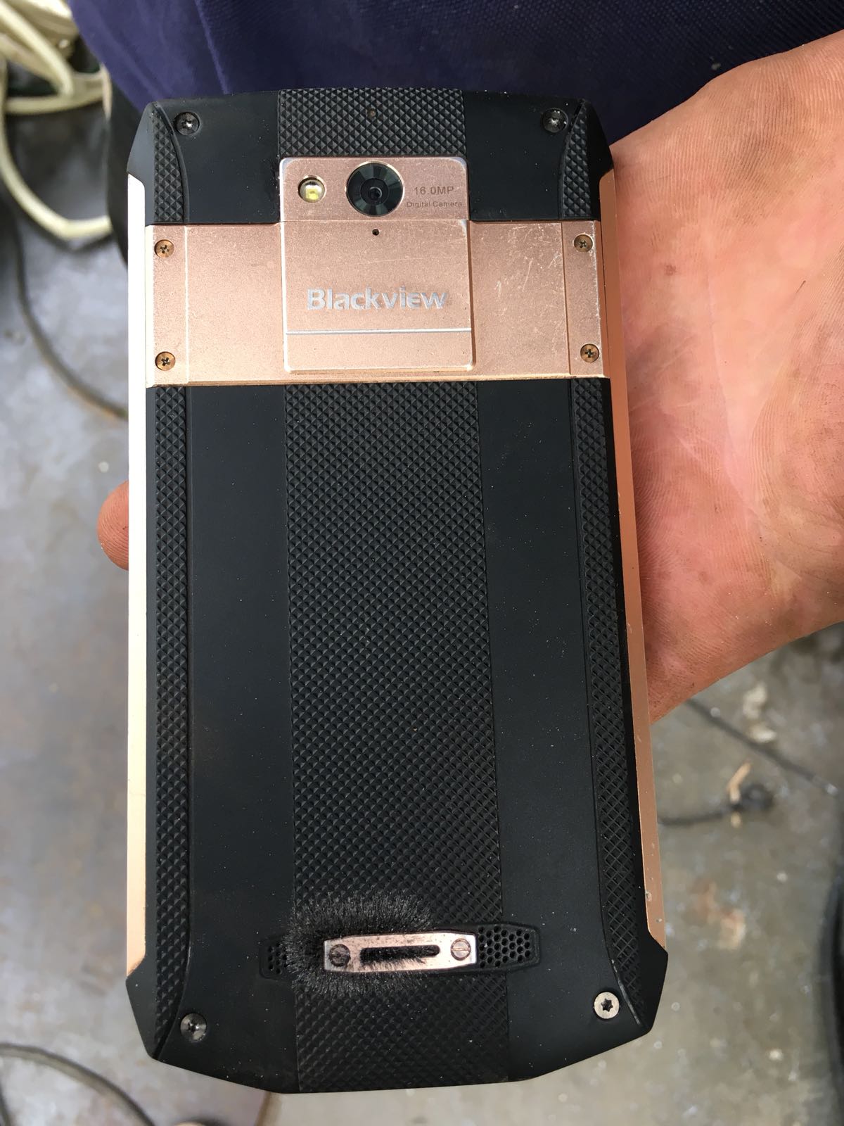

HELLO. For the guys wich the work like me around the metal and cutting metal every day. For me I find a solution which I tested and work for a few weeks almost 1 month with no problem. Down I attach some pictures. I think the pictures say more words than me to speak how I do it.
I have a problem with Ear speaker. The volume is very low. I buy and replace I think 10 times and still the same problem. I try with engineer mode Mtk. Still the same problem.
Somebody have a solution.
Thank you
Sheet cotton and iron
Sheet cotton
New speaker
A lot of metal iron
