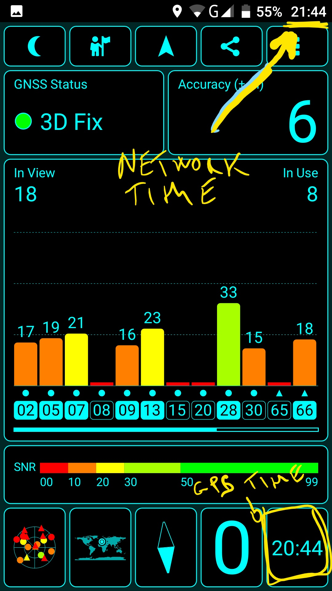

Hi i have a problem about gps time. It is one hour early than the network hour (the network hour update automatical and is the right time) . My update is v0.1_20170803_20170906-1035. Who have this problem? I think is a software problem. It is not possible to change the time. This problem is for when you post online your route but with a wrong time. Any solution , blackview_admin ?

thanks for the feedback. this is a known bug and our developers are trying to fix it.

I found a little workaround for this issue:
It seem to be a bug with summertime calculation in Android 7 for many devices with Mediatek Chipset. You can "solve" it by choosing an other timezone with the same offset but without summertime. For example if your setting is "Amsterdam GMT+02:00 Central European Summertime" you can change it to "Kairo GMT+02:00 East European Time". Caution: I guess with this setting your device may not change to wintertime automatic. So maybe you should wait with this workaround-setting until next years time change.
