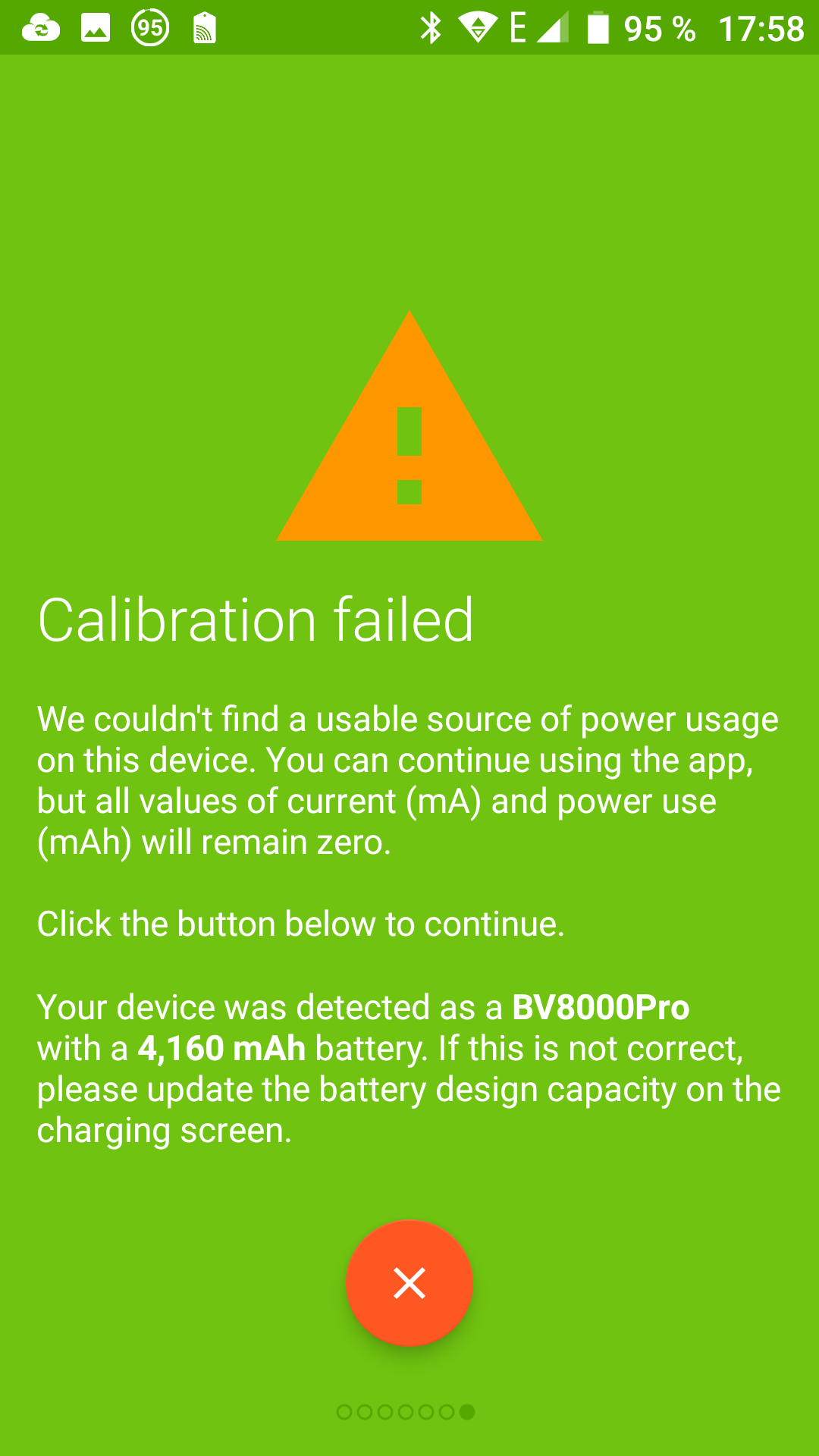

I'm new with the BV8000Pro, but my phone stay only 8 hours !!! Since my Xiaomi Redmi Note 4X stay 48h with the same usage.

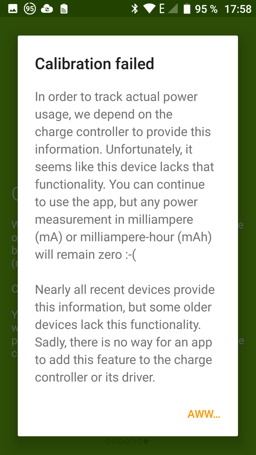

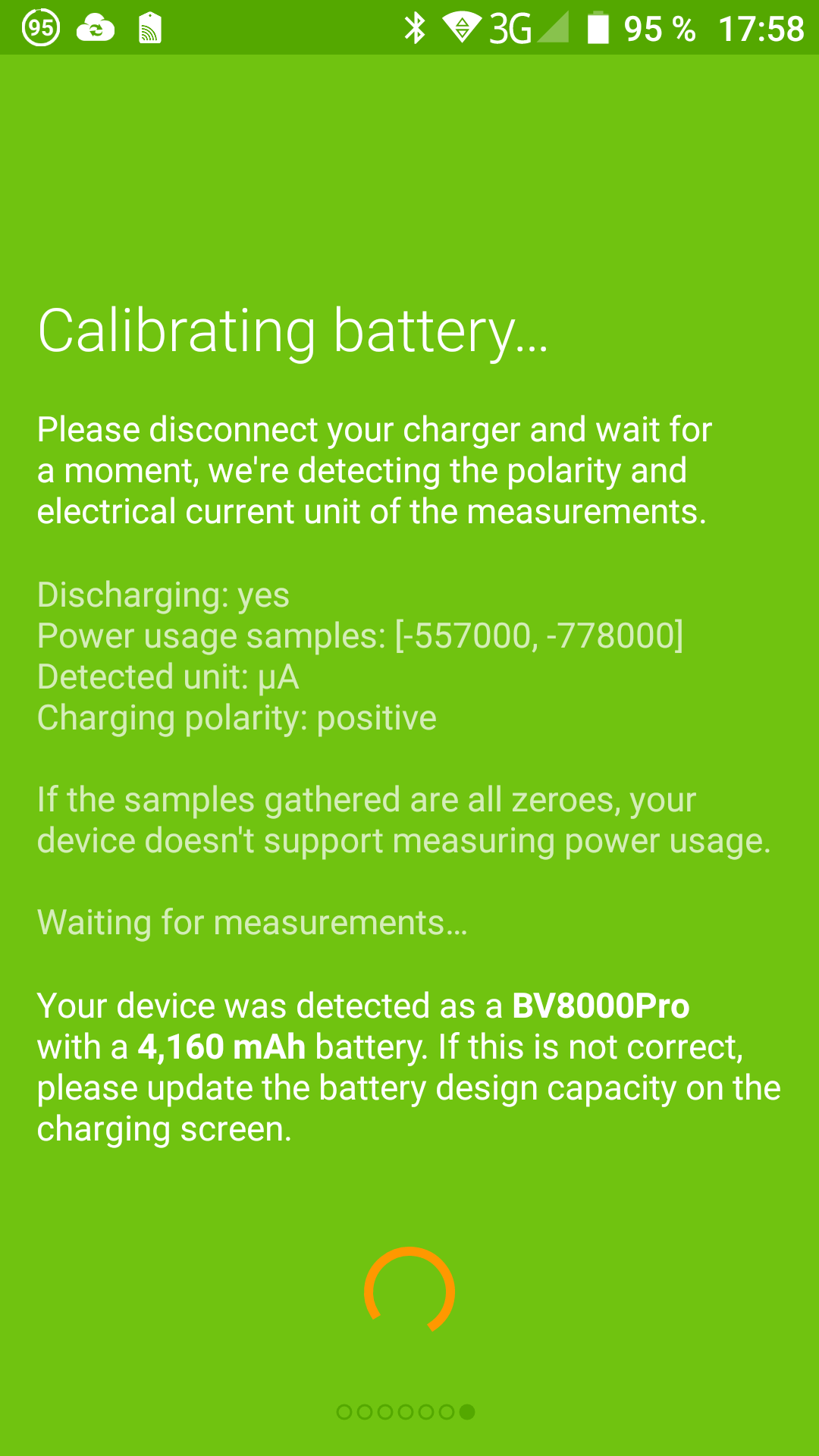

So to check the problem, I would like to install Accubattery but the calibration failed and I can't use this software but no problem on my other smartphone.
How I can solve this problem ?
The two smartphone have the same softwares and usage. Same operator but different SIM card.
Sorry for my bad english but I'm french user. Tell me if you need more informations or screenshot.

I don't have update, I'm on 0.1_20170803_20171114-1146
I've switched "Performance and power saving" from Sports Mode to Normal and now I can use my phone two days.
