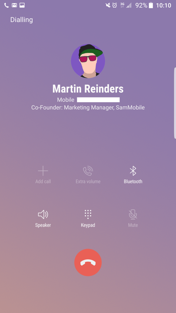

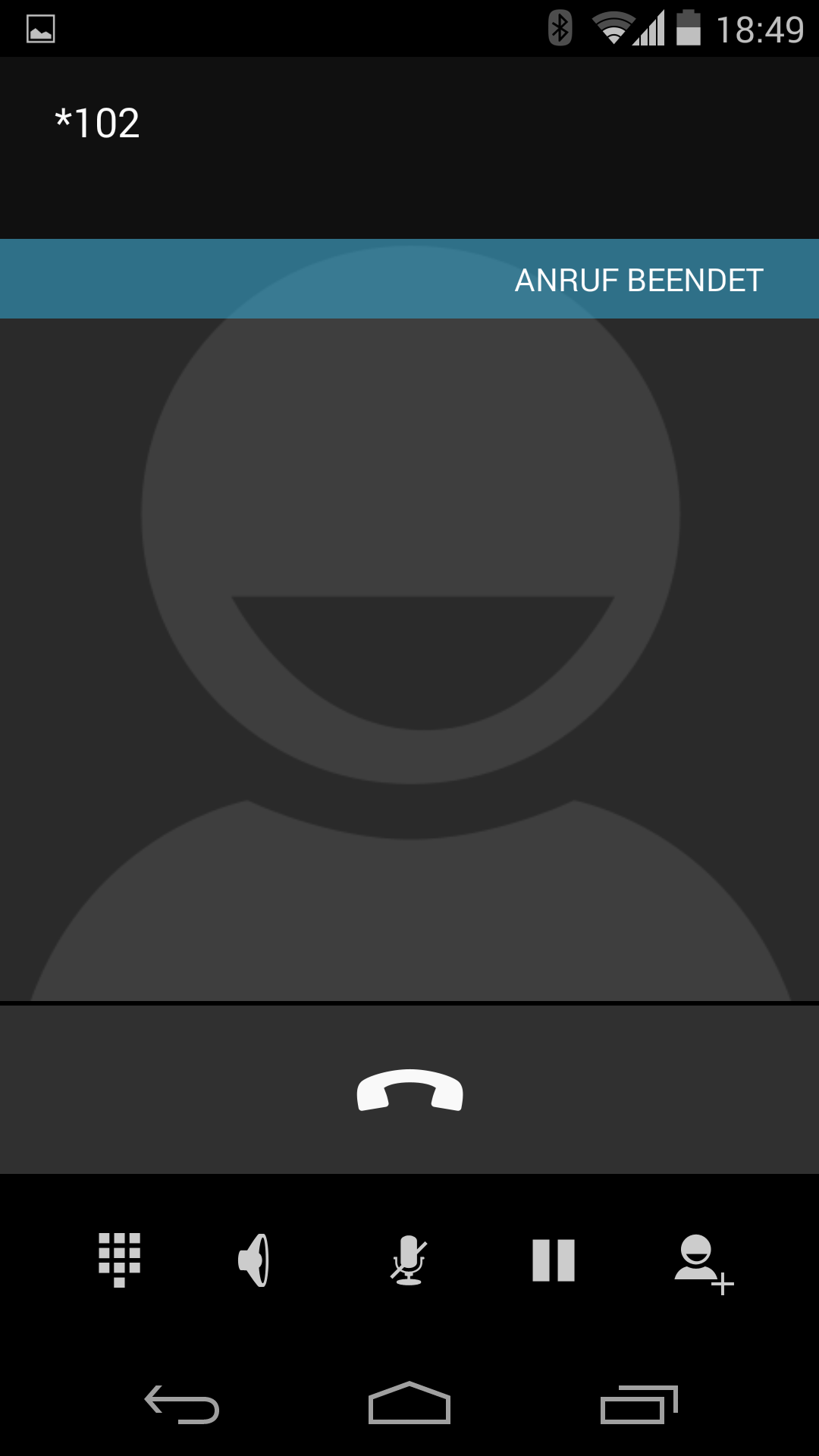

ad 1) I would prefer to have the buttons in the telephone app little bit lower on the side. like here
or like this
.Then we won´t touch the buttons by mistake, although I am liking the current layout much.
