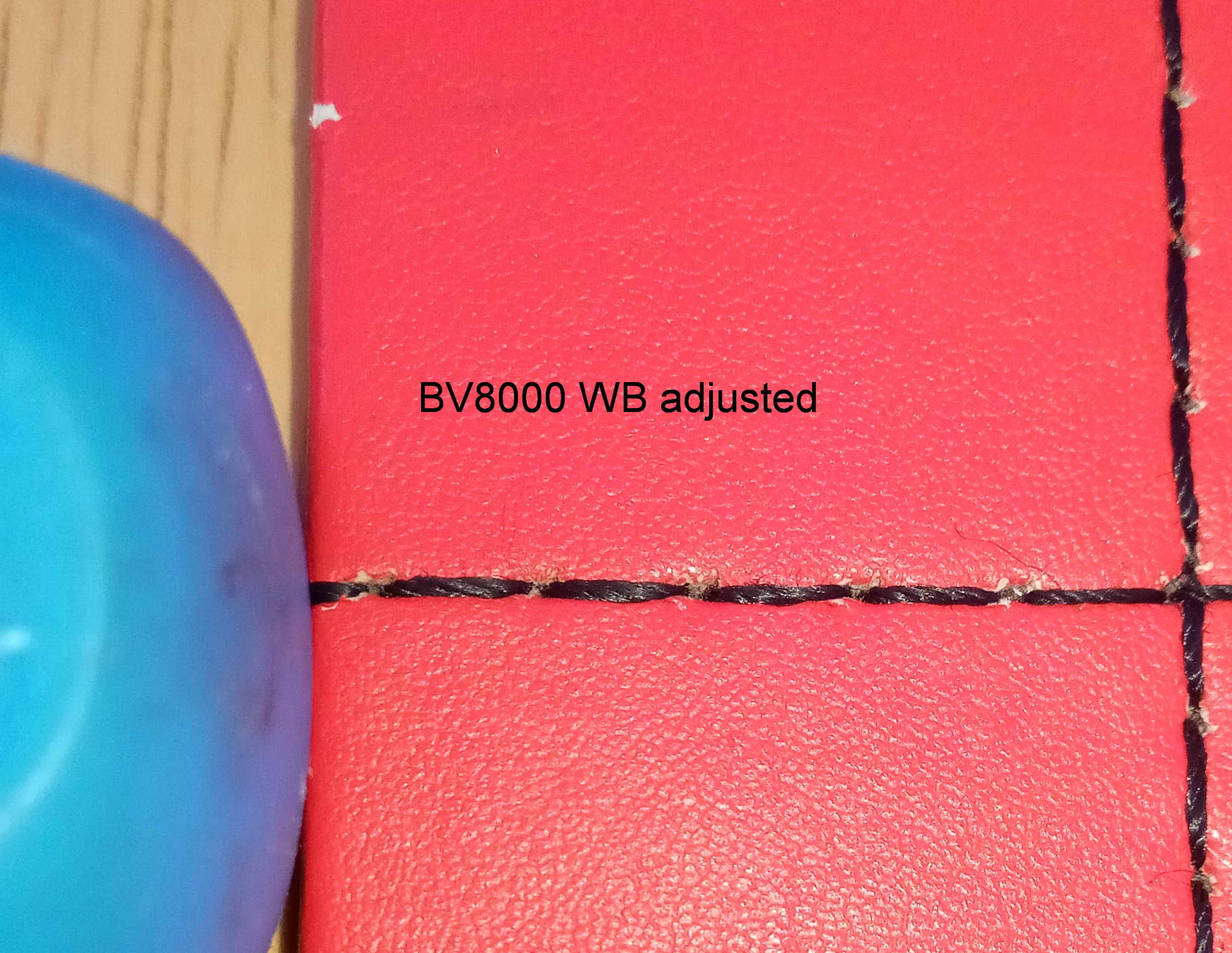

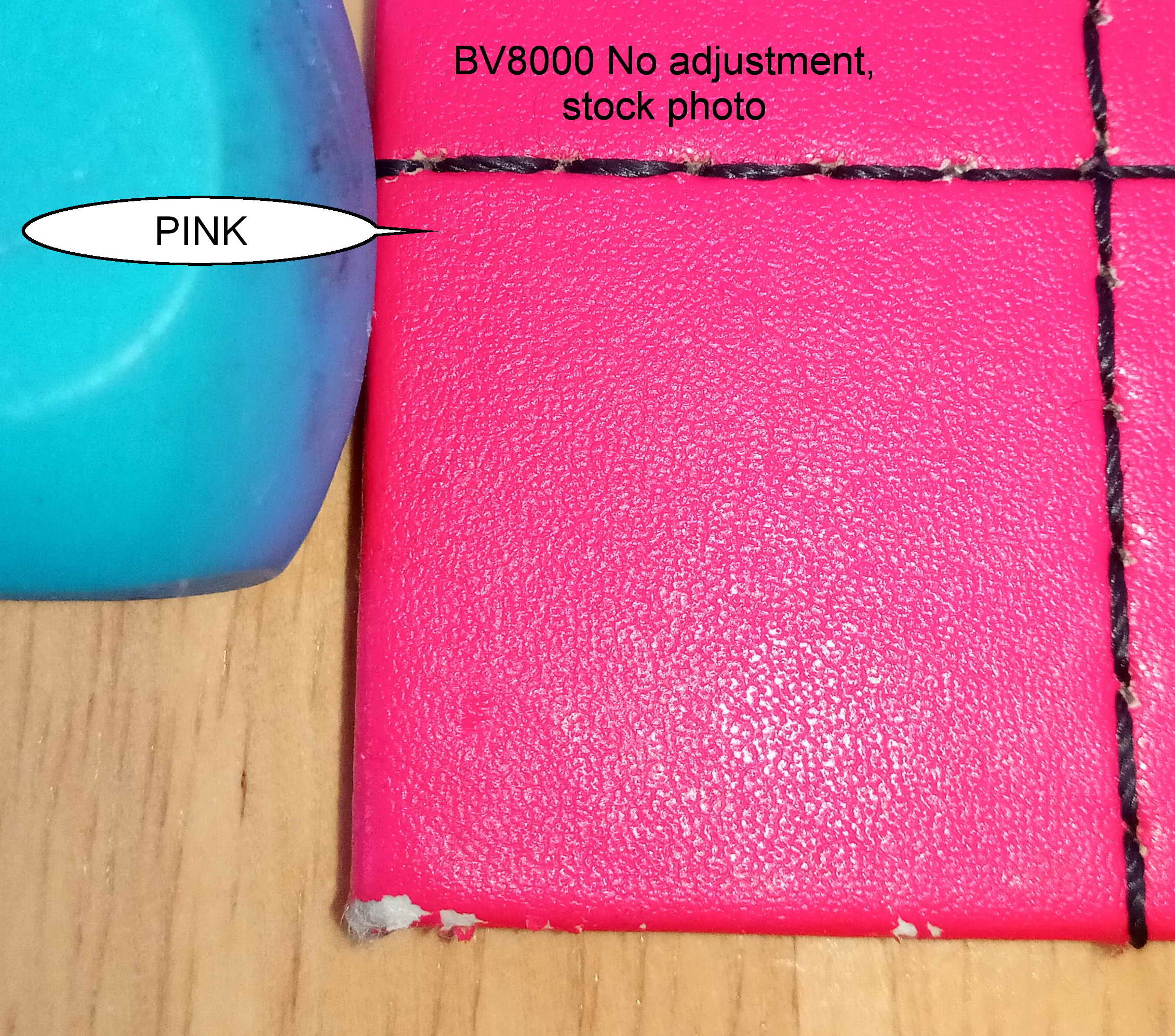

Camera PINK mess,
I simply went to Camera Pro mode and adjusted the White Balance to one notch to the right of center. Bingo!

Thanks for your help! Can you confirm your solution by posting 2-3 photos showing the difference?
So, for the moment, we have 3 temporary fix for this problem:

2) Use the Open Camera App instead of the stock camera app.
3) Adjust the "white balance" setting in Camera pro mode of the stock camera app.
Everything will be sent to the tech team for a permanent fix! Thanks for your precious help guys! ;)
