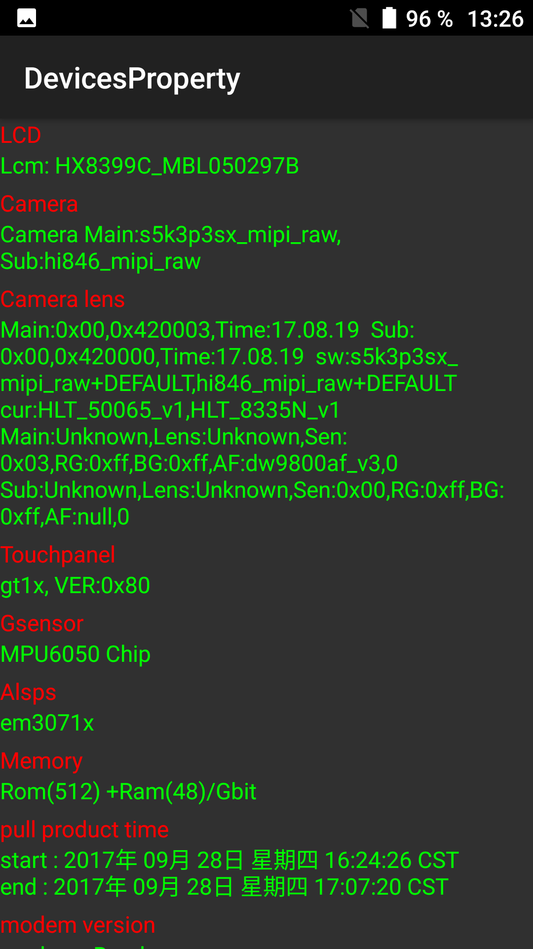

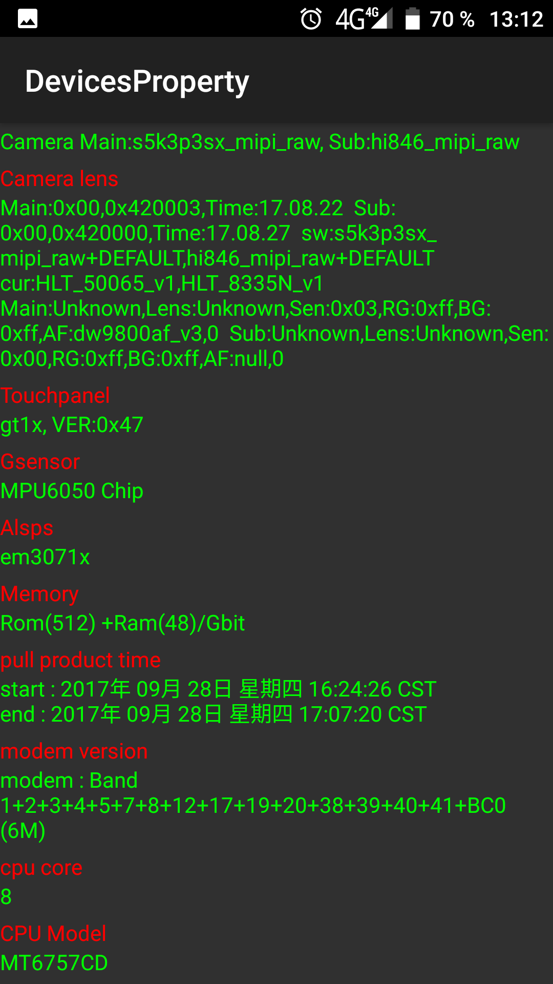

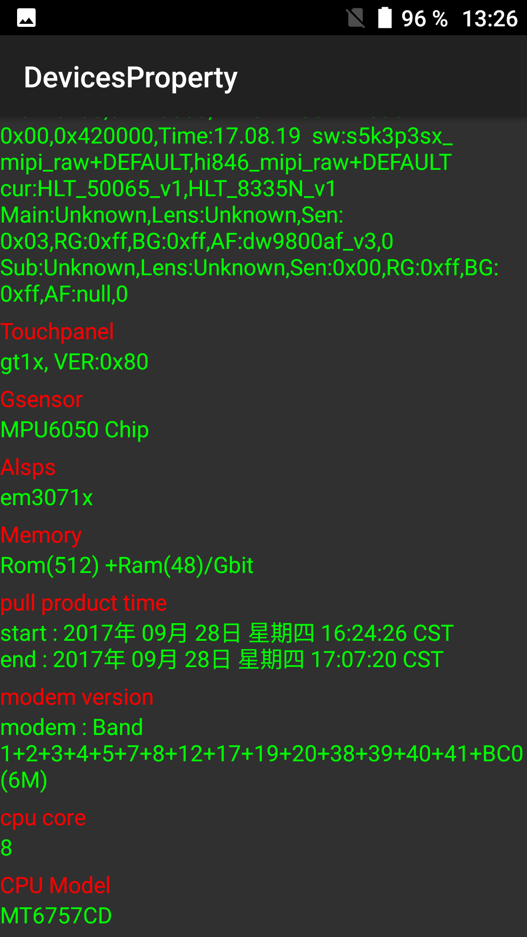

Perhaps this problem concerns one of the revisions. as it turned out they are already quite a lot, only different touchscreens I counted 3, + 2 processors on which these sensors are detected. so that revisions are already at least 6
You need to carefully check everything, in what that revision there is this problem and always it on the processor P25

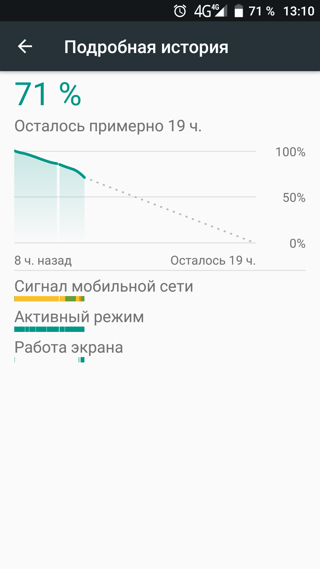

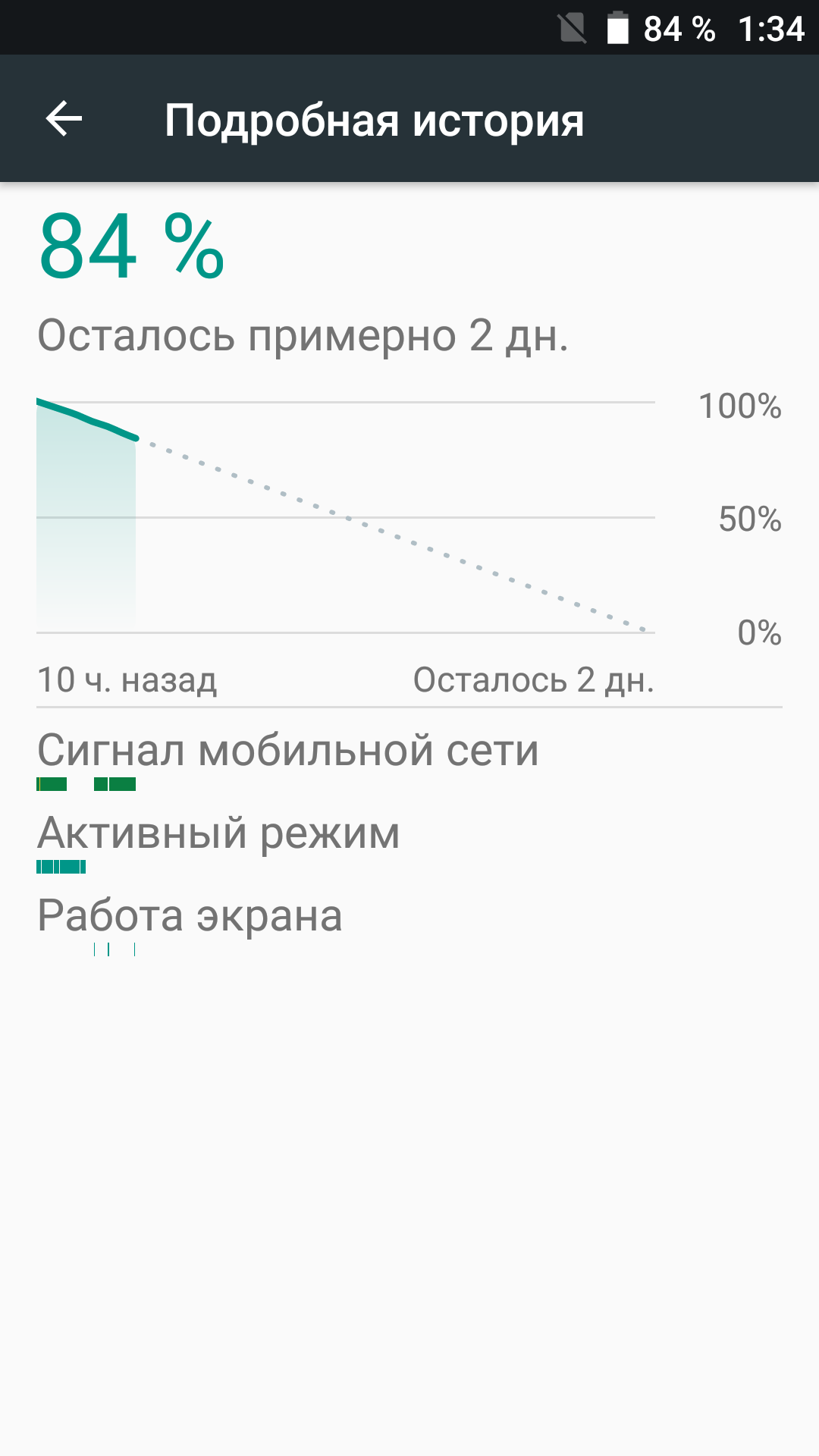

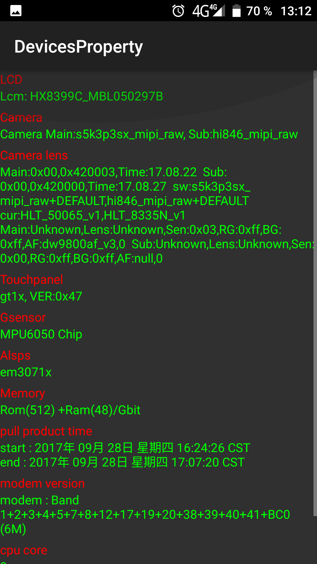

Good afternoon I provide screenshots to confirm that the phone does not go into sleep when the screen is off.

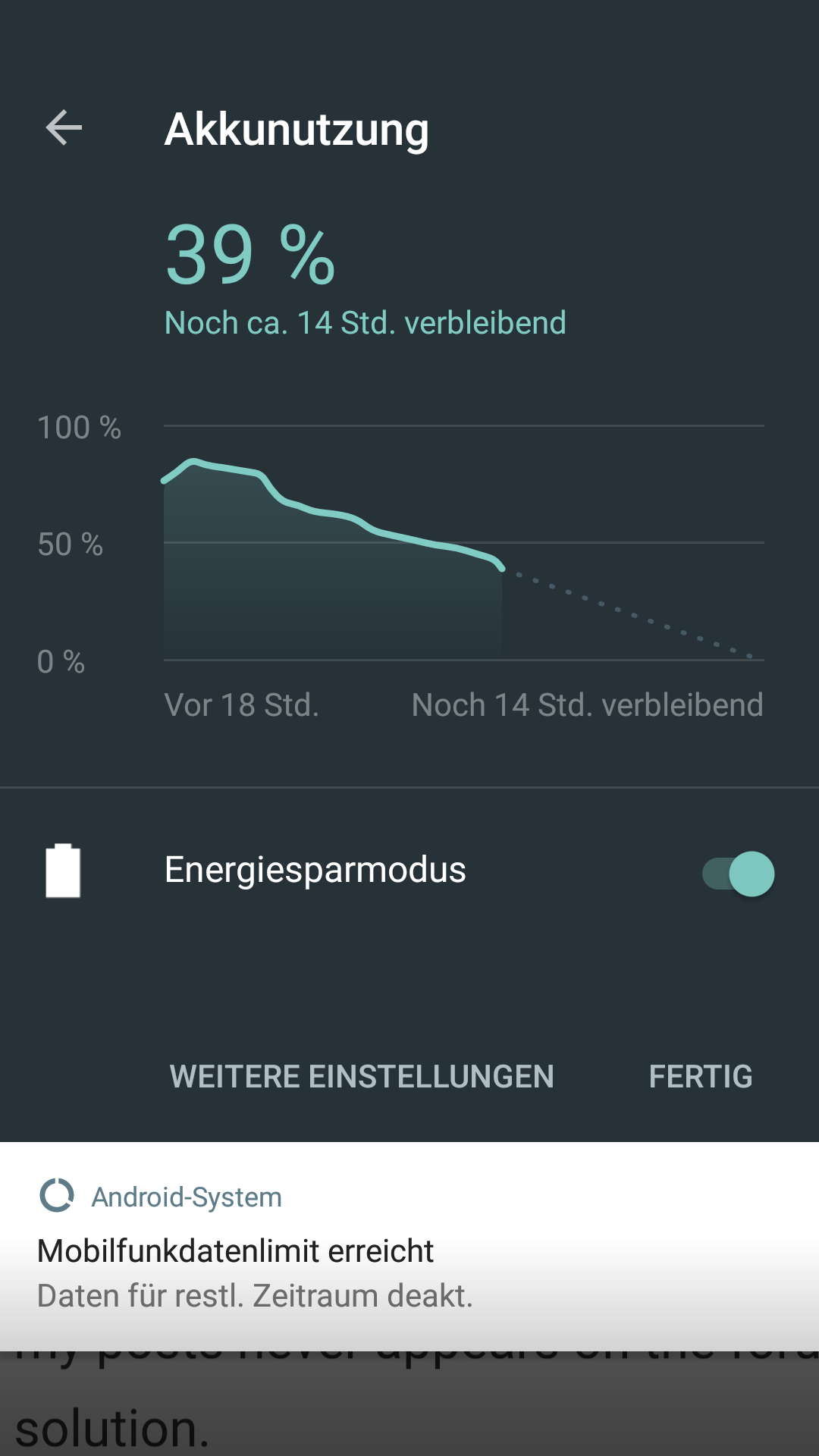

I also have the same 3% per hour, although the phone just lies on the shelf.[attachment=0]Screenshot_20171108-131004.png[/attachment]

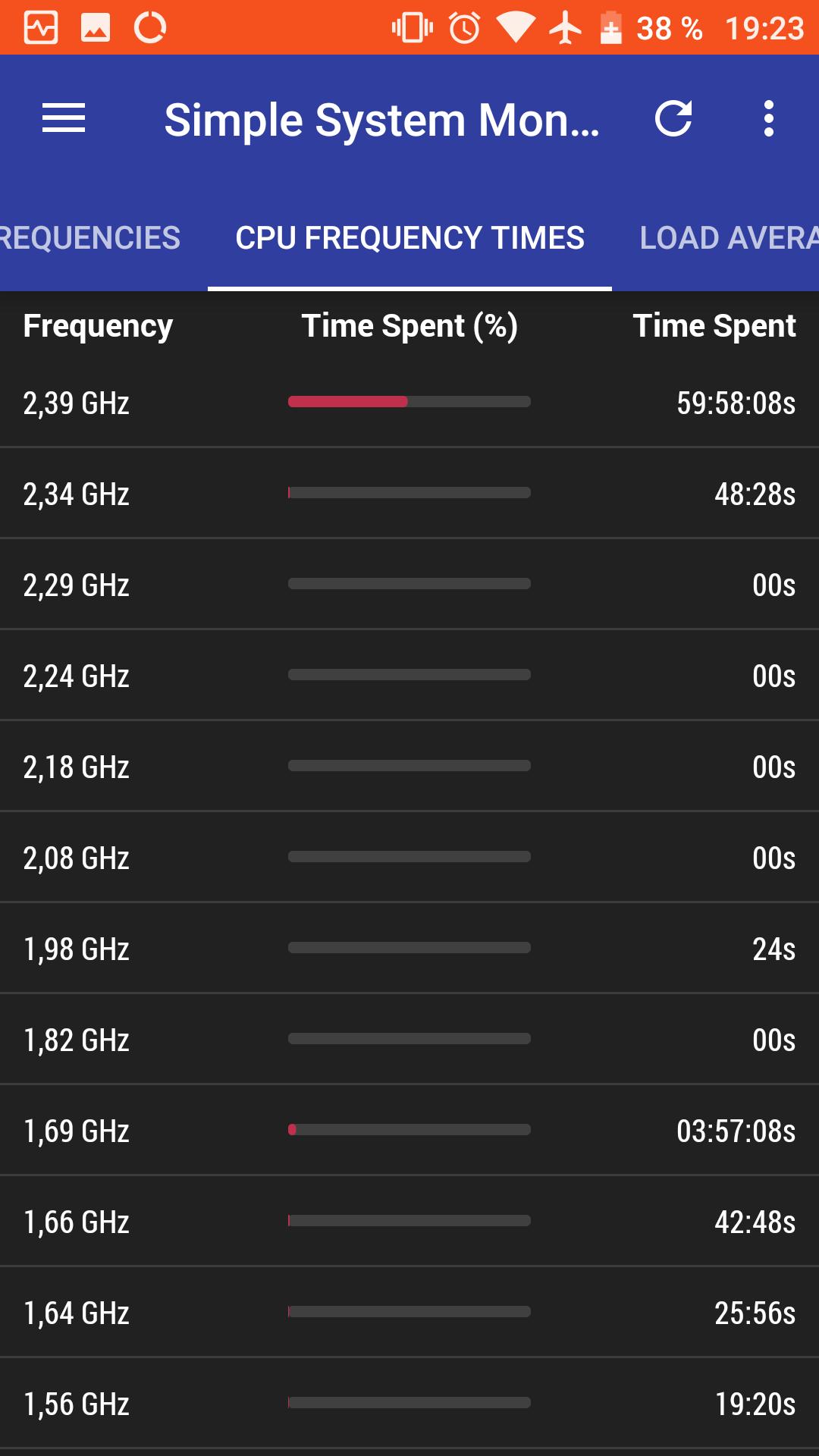

I have the same problem. I did a factory reset and now it seems to be even worse. I installed simple system monitor to monitor my cpu usage and the cores, or at least one of them, seems to stay in the highest setting half of the time.
