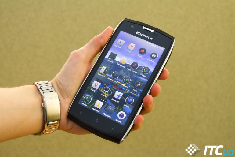

The connectivity of the phone is very important, so before you buying a phone, you must check its connectivity with your local carriers.
Connectivity:
GSM:850/900/1800/1900
3G: 900/2100
4G LTE: B1/3/7/8/20
- BV7000(1).jpg (47.55 KiB) Viewed 11279 times
