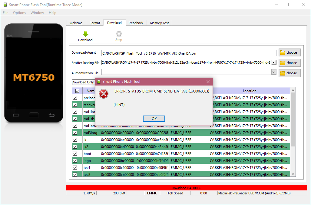

i did the ROM upgrade as shown BV7000_PRO_Blackview_20170524_20171025-1900 to get the compass back. All went well i started to restore my phone but found i didnt have a working finger print sensor, its not available in hardware.
So i used the flashtool to go back to prev rom & even the MM Rom & i get the error message shown in the png. everytime for any version i try!!
FRUSTRATING
How can i restore my phone to get a working finger print sensor !!! Is your ROM file corrupted, & why are we getting them from mega.nz as RAR format!!! instaed of zip.
I need to know how to restore the phone to a good fully working copy of Nougat with finger print sensor & compass please
blackview BV7000 pro fail.PNG (74.74 KiB) Viewed 15242 times
l
Press Volume +
Pablo0208
Posts: 7
Joined: Sat Apr 01, 2017 8:39 pm
Re: ROM UPGRADE with COMPASS
Mon Dec 04, 2017 10:50 pm
super that seems to have done something.. flashing is beginning a-fresh , Many thanks for this tip
