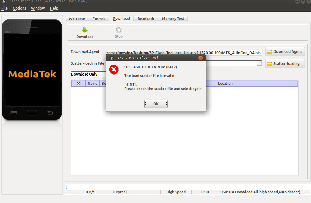

I'm trying to update bu flashing the latest firmware (Android 7) because my BV7000 pro died due to the 'doesn't charge problem' ( viewtopic.php?f=175&t=115474&start=10 ).
I downloaded flash_too for linux, but scatter file is not recognized.
I checked that there are not chinese chars in the path, I also tried to load the scatter file from /tmp but it doesn't work.
I also checked the content of the scatter file, it seems fine.
Could you please help me?
scatter file problem
Screenshot from 2017-07-31 20-34-41.png (69.3 KiB) Viewed 10318 times
Here is a frame of the log of the SP flash tool (it seems some key in the scatter file are missing):
08/01/17 07:16:55.524 BROM_DLL[6054][6214]: DEBUG: LayoutConfigFileParser(): Layout file name(MT6750_Android_scatter.txt). (LayoutConfigFileParser.cpp:103)
08/01/17 07:16:55.524 BROM_DLL[6054][6214]: DEBUG: Parse(): m_config_file(/home/fmessina/Desktop/SP_Flash_Tool_exe_Linux_v5.1520.00.100/t725y-jk-bv7000-fhd-512g32g-3m-bom117-N-from-M_BV7000_PRO_Blackview_20170622_release/MT6750_Android_scatter.txt). (LayoutConfigFileParser.cpp:443)
08/01/17 07:16:55.588 BROM_DLL[6054][6214]: DEBUG: Parse(): get LAYOUT_SETTING_SKIP_PMT_OPERATE:yaml-cpp: error at line 7, column 7: key not found: skip_pmt_operate. (LayoutConfigFileParser.cpp:622)
08/01/17 07:16:55.588 BROM_DLL[6054][6214]: DEBUG: Parse(): get skip DL info option:yaml-cpp: error at line 7, column 7: key not found: skip_write_dl_info. (LayoutConfigFileParser.cpp:633)
08/01/17 07:16:55.588 BROM_DLL[6054][6214]: DEBUG: Parse(): get slc cell percent:yaml-cpp: error at line 7, column 7: key not found: slc_percentage. (LayoutConfigFileParser.cpp:645)
I'm using the SP flash tool for Linux 64 bit.
Many thanks for any help you can provide.
Re: Scatter File Don´t Work (Only for 6.0 OS)
Posted: Mon Aug 14, 2017 6:33 pm
by blackview_admin
You can try an other version of flash tool or use a windows pc.
