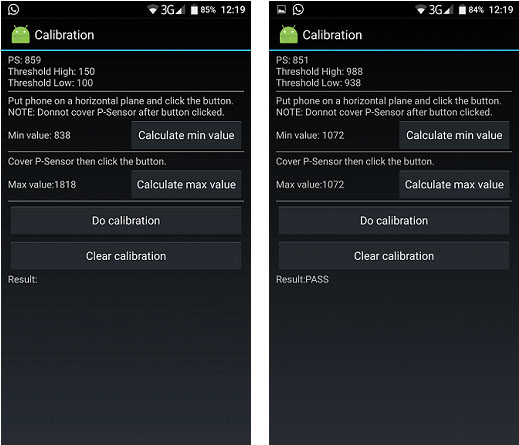

peluso
Posts: 31
Joined: Thu Mar 30, 2017 3:26 pm
Re: Proximity sensor problem
Mon May 22, 2017 10:02 am
Successful calibration, says PASS
But the problem remains the same.
Restarted phone, nothing has changed.
Senza titolo-2.jpg (56.82 KiB) Viewed 7153 times
Phil
Posts: 245
Tue May 23, 2017 11:08 am
On my phone there are complete different values (TS High 150, TS Low 100) and it seems I am not able to calibrate.
If calibration works for you and don't help I don't know what else to try.
