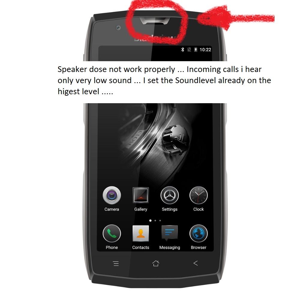

I just got the phone 2 days ago and have also touble to set the volume on the speaker were i hear the calls ... I try many settings but noting works till now properly.
In the attachment i put you a pic wich speaker i meen ...
Also i get complains that people here me on a low volume.....
If i dont be satified after the weekend i will return the phone ...
Thats the second BV i use and also whit my BV 5000 i had a hard time .

Posts: 4
Joined: Thu Apr 13, 2017 7:09 pm
Re: Low volume on microphone
Thu Apr 13, 2017 7:20 pm
Hello
@adyleigh
How i can change the Engineer code ?
Greetings
