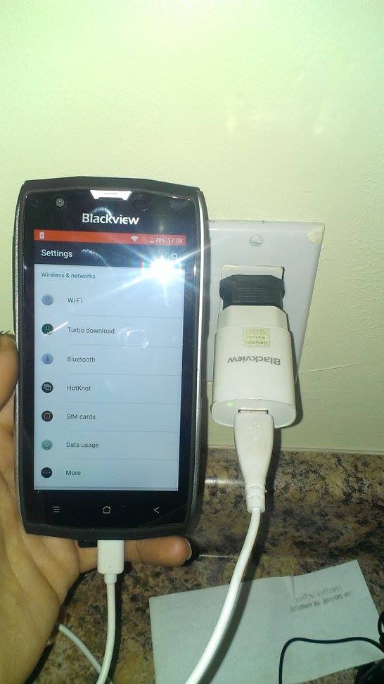

In this photo, is the wall charger that came with the phone.. and the adapter to make it into 110 does work I have tested it with a different device, Do you think there is anything I can do, Or is it a hardware issue and im going to have to send it back for warranty....

From your picture, we can not see that the phone can be charged or not.
But from your comment, do you mean that your phone can be charged now because you used an adapter to change the voltage?

@admin No, his phone still don't charge. If it would charge the red bar on top would go away.
@CoastalBudgetBuilds Had you checked all connections? I once had the problem that bv7000pro don't start charging and noticed that I just had to push the cable a little bit more inside to let it work. Maybe also try an other USB C cable. And if really nothing helps you, you could change it over guaranty of your seller.
