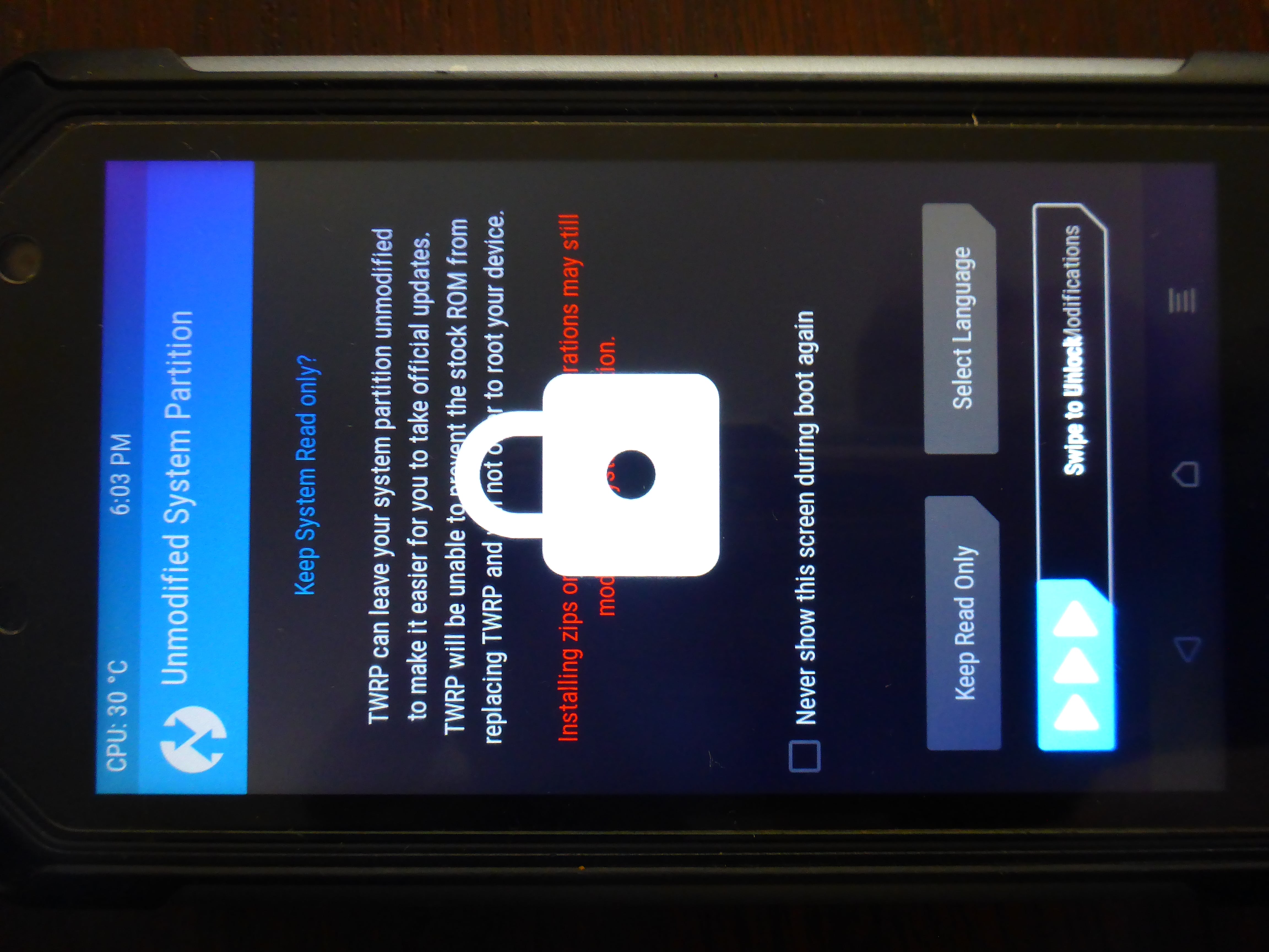

When I do this, I start the phone in boot mode and the TWRP initial screen comes up . It is unresponsive. When I hit the power button, a Padlock appears on the screen. Nothing works. When I restart the phone it completely disappears from my phone and it's back to the old boot menu when I boot into it. No sign of TWRP.
When I do get into the TWRP screen and press any key, this is what happens.. See below..
And the screen is unresponsive!

Procedure is OK but for unresponsive screen you have to use a mouse with the OTG USB connector of your phone.

Thank you, that worked well. Surprisingly.
Not sure why I can't use the touch screen with TWRP.. Some BV6000 phones seem to have this ability.
