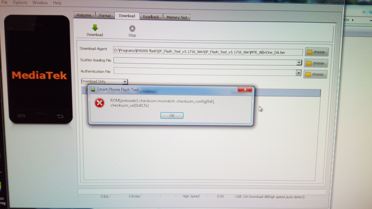

I have problems with my BV6000. I had stock ROM from factory - i dont know how version it was, but I got a viruses into phone and flash to this ROM 20170708, but the phone losts the signal.
Then i flash via SPflashtool this ROM 20170719. So the phone didnt detect any SIM cards.
Then I flash via SPflashtool this ROM 20170321 and the signal goes down too as in first case.
Then i downloaded oldest ROM version 20160822. But I cant load Scatter -loading file into SPflashtool.
Can you help me with this problem, what i doing wrong ? Can you I fix my problem.
Can you check it ? I attached a photo of this problem.
Thank you

ThomasSc
Posts: 21
Joined: Sat Sep 03, 2016 8:31 pm
Re: BV6000 problems - update ROM, SIM no signal
Thu Sep 21, 2017 12:53 pm
It's very easy.
You have to rename "Checksum.ini" to e.g. "Checksum.ini1".
Happy flashing.

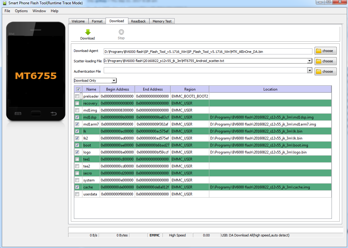

grAwp
Posts: 156
Thu Sep 21, 2017 3:10 pm
it isnt the right way, but i cant now check all columns see the picture - preloader, recovery etc.

grAwp
Posts: 156
Thu Sep 21, 2017 3:37 pm
If I delete from ROM version 20160822 folder :
Checksum.ini and CheckSum_Gen.exe everything was OK and I could flash the phone with this ROM.
