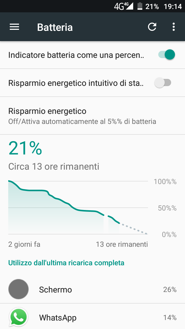

HI
here again the strange interruption of the graph

mauron wrote:
HI
This interruption of the graph is normal, it means the phone entered into a battery saving mode, in which the phone is sleeping to save energy, and normally occurs after a period of time without using it, for example when you're sleeping. Nothing to worry about, since it makes your stand by time last longer!
The only thing in my case, is that this interruption of the graph appears and disappears randomly, sometimes it happens, sometimes not, without being able to know why it entered in that mode at night, and why sometimes not...

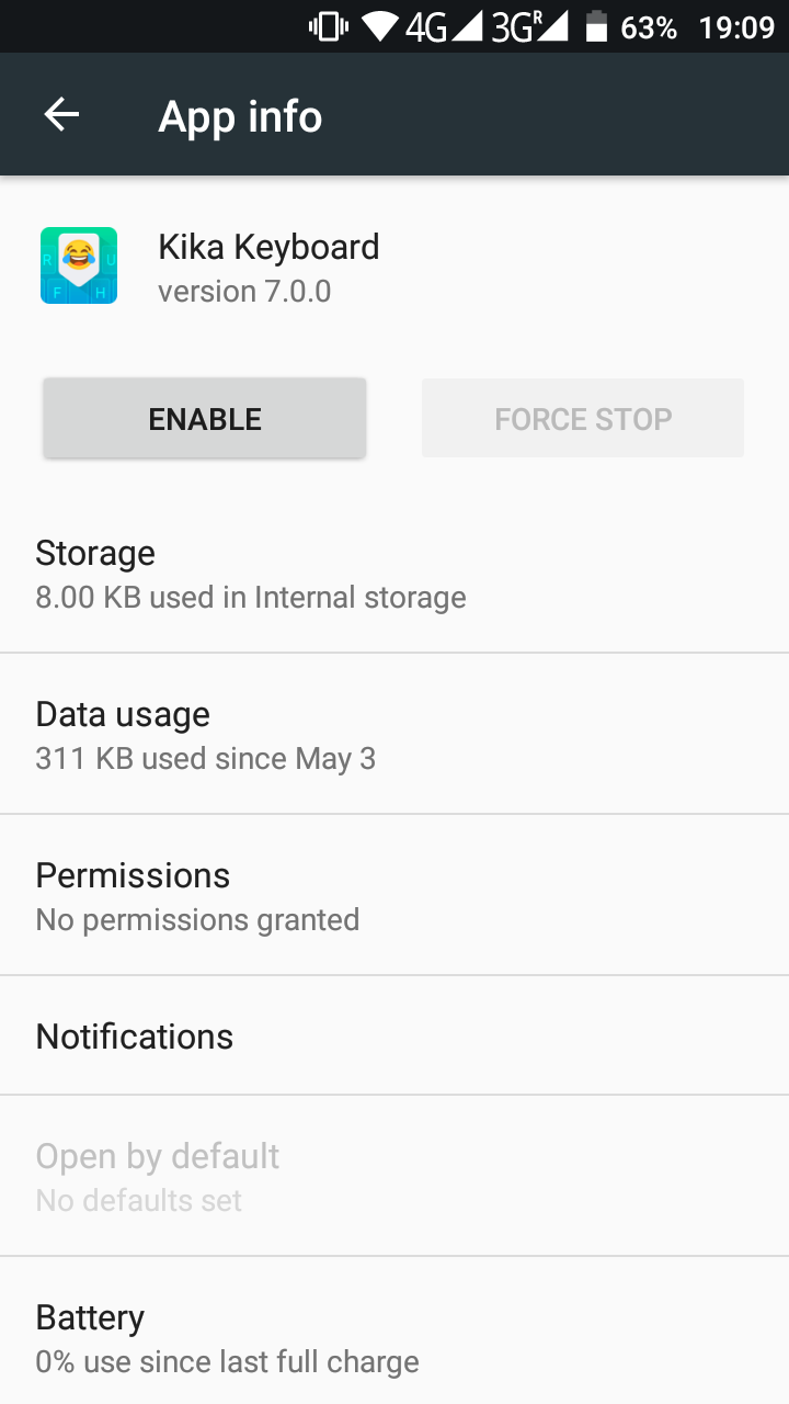

Hy Everyone!
I flashed the latest rom. I'm also give the root access for myself with TWRP+Magisk. Everything's fine but a keyboard called Kika keyboard appeared at the apps. Is anyone else noticed?
I'm also unable to uninstall it.
Re: 20180330 update
Mon May 14, 2018 12:34 am
If you are doubtful, just disable it.  ;)
We don't put malwares in our phone, by the way.

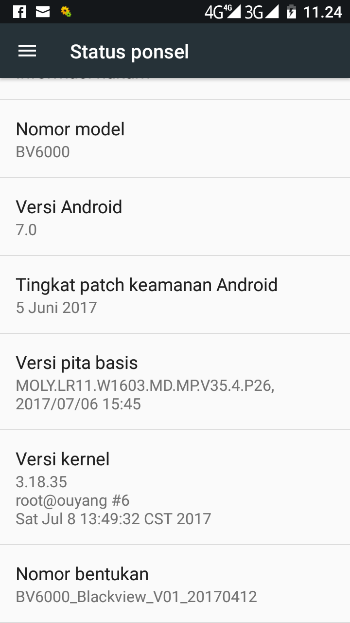

I just download the zip file for local update my phone..
But why it still the same as before?
Thanks..
