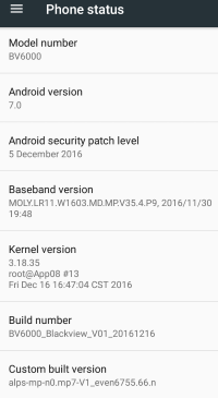

I don't have such an issue with Android 7 ROM 20161216.

BV6000_blackview_V01_20161216
Phil, is this exactly what you have on your phone? if so then I will first try a factory reset on android 7.

Hmmm. My gps time (gps status utc time or android settings with gps time data) is an hour slow. Running Android 7 with 20161216.
