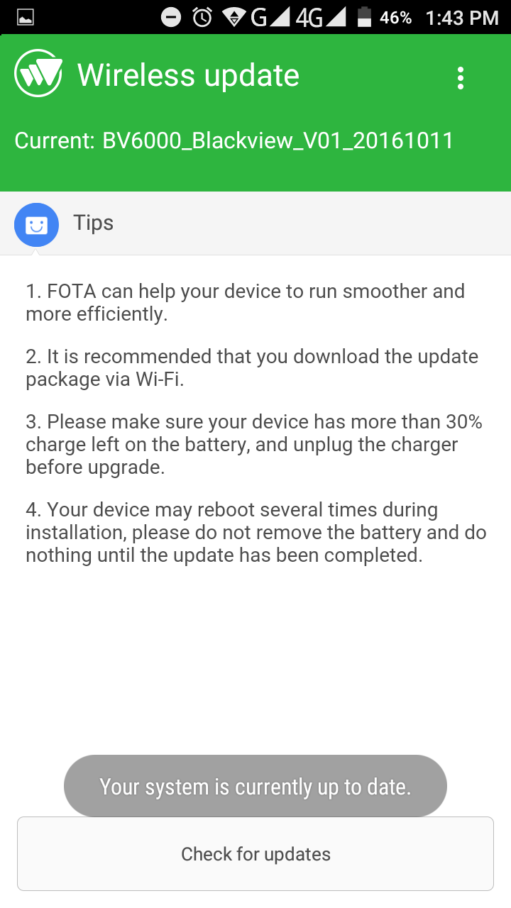

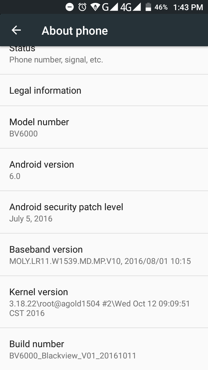

I had some problems with my device and after performing hard reset it is showing July 5,2016 patch level, Build no. 20161011.

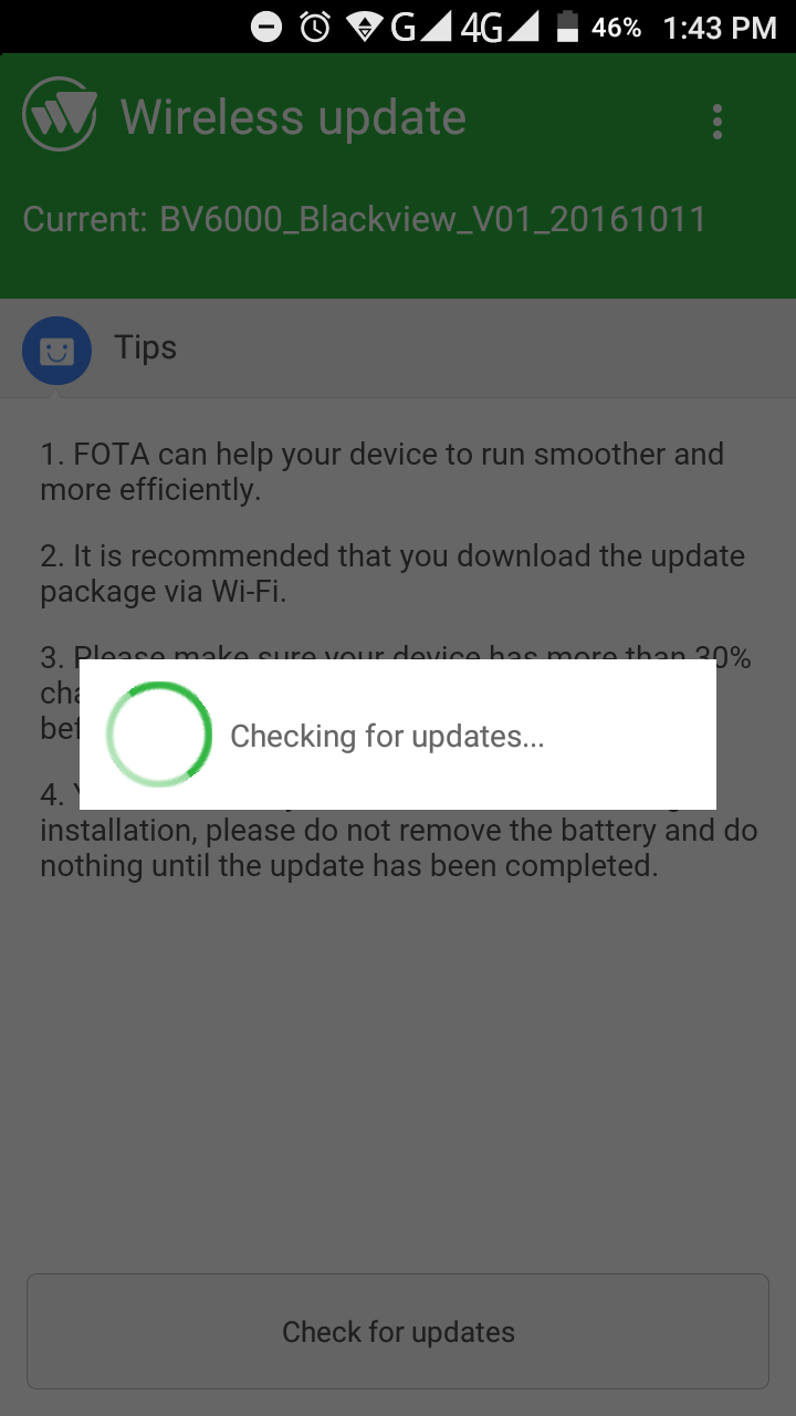

I tried wireless update but it is showing my system is currently upto date.
How can I get Andriod 7.0 after this?
Need help plz.

Plz see the attached pictures during the update.

Get the local 20161025 ROM from here viewtopic.php?f=144&t=101183#p284253 and perform a local update following this viewtopic.php?f=144&t=41724
Afterwards you should get Android 7 updates over the air (OTA)
