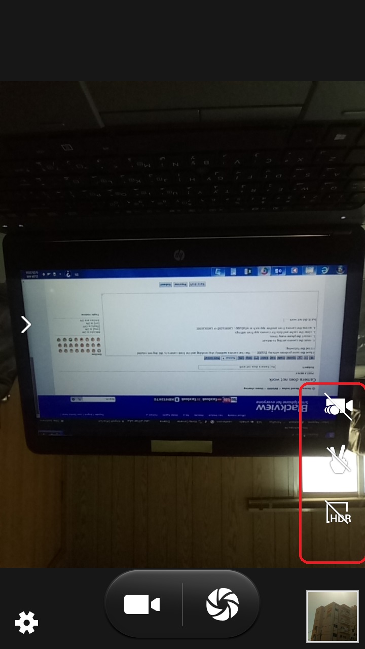

I recently bought a BV6000 for the first month using it was awesome but unfortunately the camera suddenly stopped working ...
I was using the rear camera when its stopped working and closed the camera app ... I tried to restart the app when I found that the rear camera is not working and the front camera was rotated 180 degrees and I noticed that the "swipe camera" button was disappeared ....
I tried the following steps:
1.I tried to restart the phone but it does not work
2.I tried to install a camera applications such as camscanner, camera 360, Whatsapp camera but it does not work
3.I tried to clear the data and cache for camera from settings but it does not work
4.I tried to search for firmware update but it was up to date
5.I tried to "wipe data" by pressing the volume up button while pressing the power button and choosing the wipe data option ... but it does not work
The Build number is BV6000_Blackview_V01_20160822
Attached a screenshot from camera clarifies the above mentioned issue .... Please help me to solve this issue
