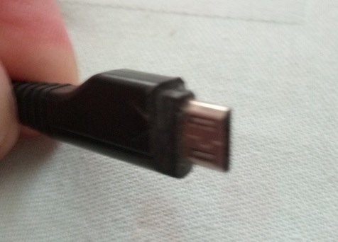

Sun Jul 24, 2016 10:12 am
All of the sudden charger won't charge battery.
It is weird. I left it on a charger for a few hours, but battery level stayed at 34%. Battery voltage was rising, i stopped at 4,25V, but percentage stayed at 34%. Phone indicated that it is in charging mode. I tried different chargers. It also didn't show calculation that shows remaining charging time.
I then tried charging with phone turned OFF. It charged phone normally. I disconnected it at 75% and reconnected it again and it stopped charging. It stayed at 75% connected on charger for 1 hour.
I still have original firmware and didn't change any settings or added new apps. It happened all of a sudden.
I will update with further findings or pictures.
I found the problem. Original USB charging cable is faulty. When I said that I tried different chargers I used them with Blackview supplied cable. I don't know if it has bad connection or high resistance. I won't ever explore it further and throw the cable away.
I now modified other micro USB chargers to fit in BW6000 socket. It charges normally now.
The only think that is odd to me is that phone showed correct amperage for charging, and battery voltage was rising. Only percentage stayed the same.
