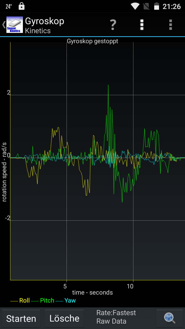

I made two videos showing the "Sensor Kinetics-Innoventions" app:
https://www.youtube.com/watch?v=LARkSzgvPjU
https://www.youtube.com/watch?v=mMBRJdS3R88
In the first video I recorded the values as a diagram, this is it:
As you can see when I moved the head up (pitch) the sensors recorded a roll (yellow line). And when I rolled it it recorded a pitch (green line). Yaw seems to be correct btw so I didn't show it. Also the accelerometer works correct. If an app is using both at the same time - accelerometer and gyro values - those don't match and you end up with apparently random values.
Sorry for the bad quality. I hope you can recognize what's going on there.
Even if it is a hardware failure I guess the problem could be fixed by software. The values just have to be switched. But I couldn't find an option like this.
